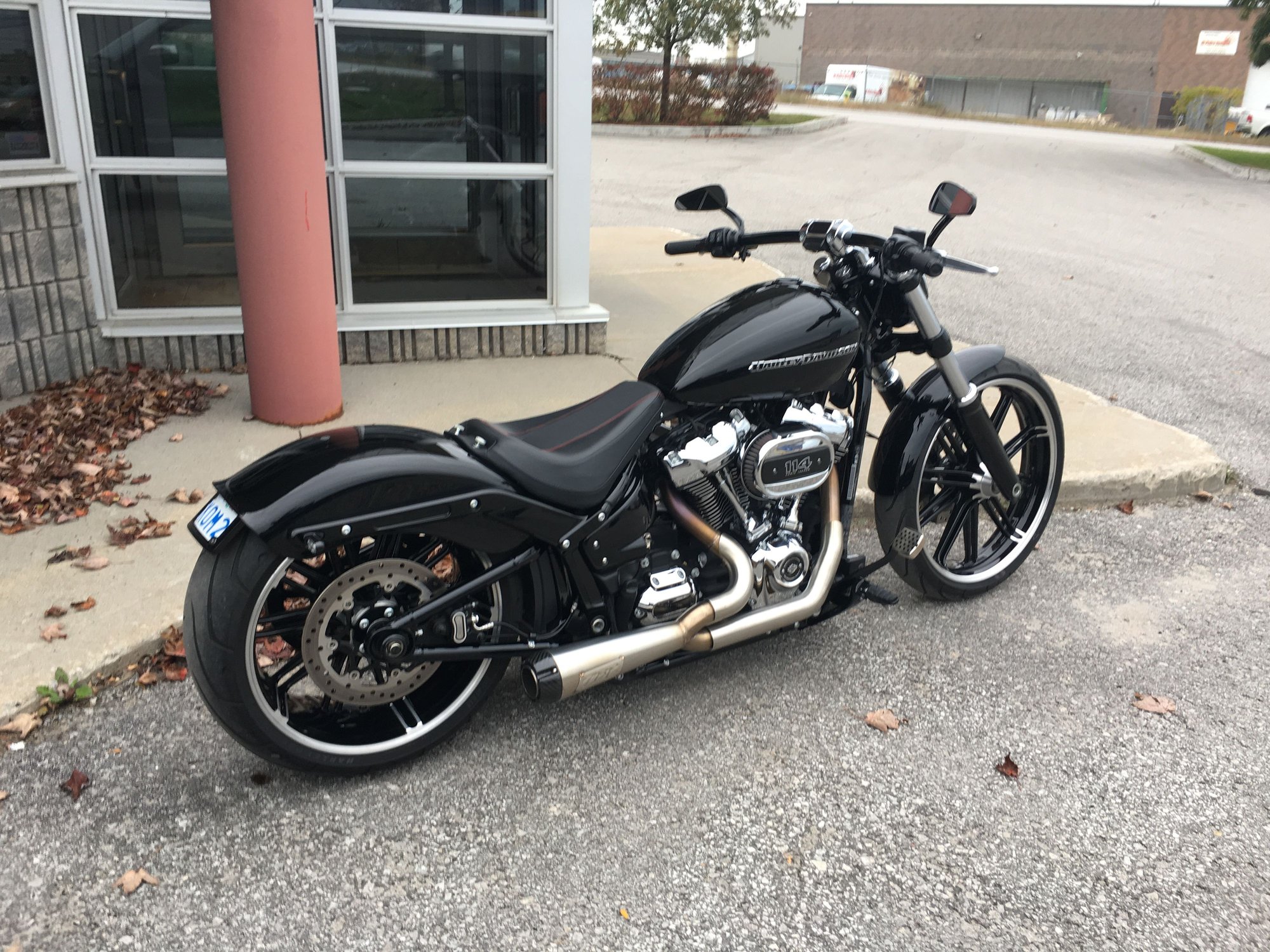

Originally Posted by Blackp5ca
I'm running Platinum Air in the back but before I did the air suspension swap I found placing the rear plate up under the rear fender closed down that gap a bit from the rear and made it look a bit better.
I used a generic curved plate mount (may have been Kuryakyn I cant recall?) and just fabbed up my own mount to the existing bracket under the fender. Maybe $80 invested?
I know this pic isn't the same with the air but you get the idea on the plate location.
I really like that exhaust! I contacted Two Brothers about it but they said they are not currently making the 2:1 for the Twin Cam Breakout right now, only 2018 and up.
