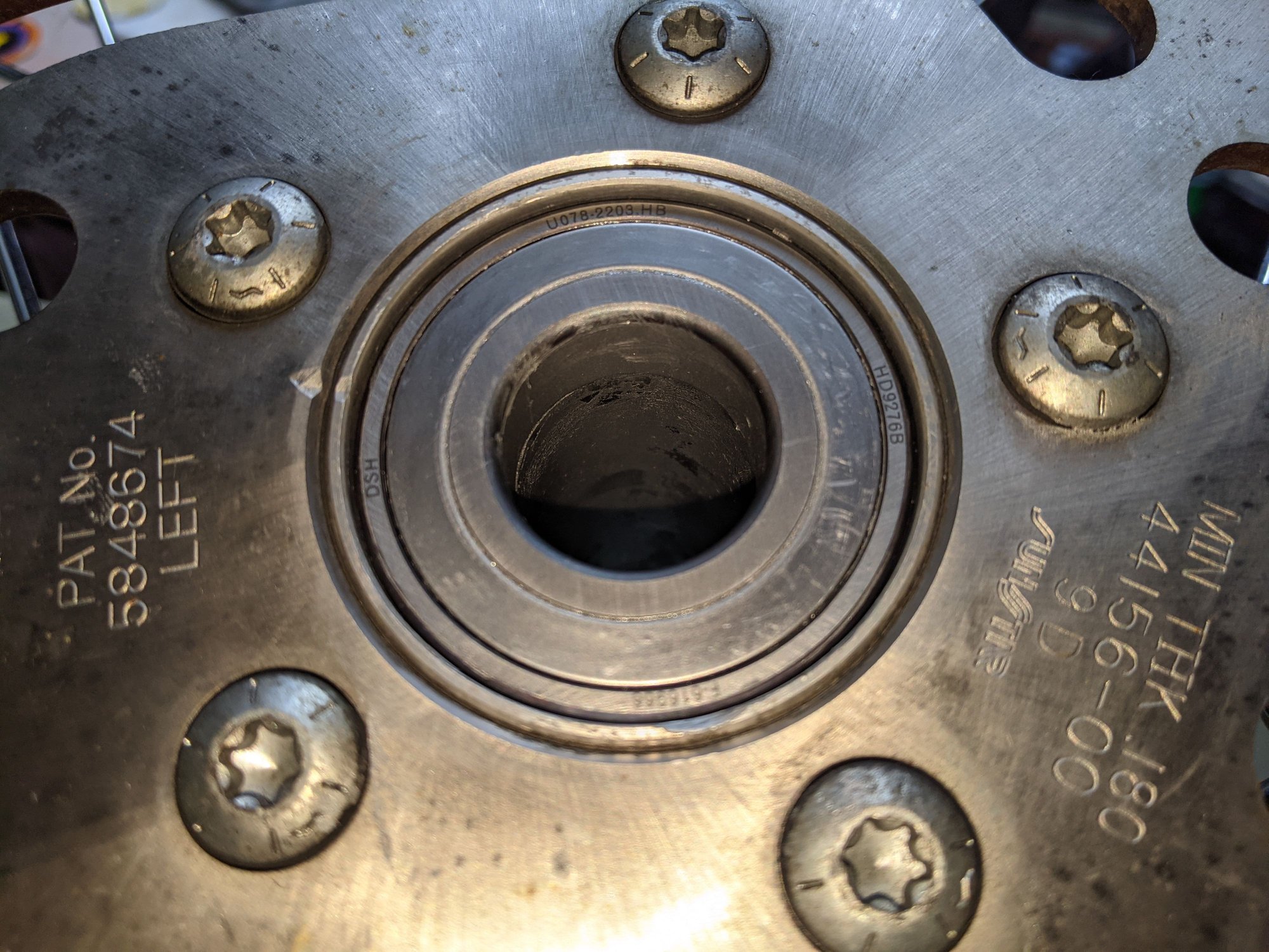

Those look pretty pressed in to me, maybe someone that has a keener eye than me can say otherwise. I can move the middle spacer in-between the bearings up and down just a smidge, but not side to side towards either bearing. They're the correct bearings according to Ronnie's.

It does look right. Even looked up the bearing numbers and those are correct as well. Something is obviously different tho, even your old bearing picture shows it in further which would make up the difference in the caliper.

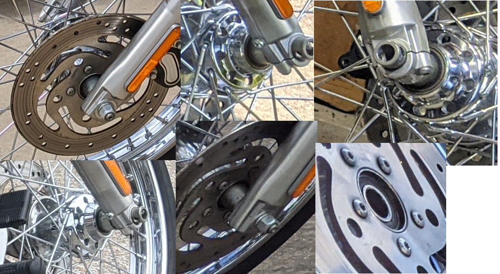

I've gone through every picture I have of the bike, and of course the side I want isn't the photogenic side. So here's a hodge podge of clippings from those photos. It definitely looks like the rotor side is more pressed in than the other, but at this point I'm about ready to believe it's an optical illusion.
you dont by any chance have the old bearings that came out or can get them. Then you could measure the bearings for width
