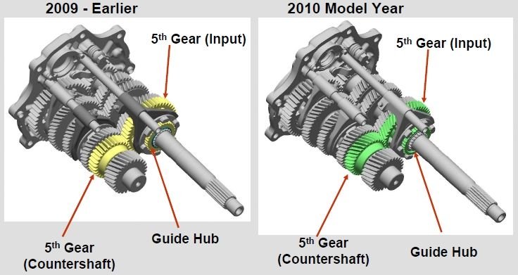

Actually the fifth gear whine is for the 2007 to 2009 production years. The fifth gear mainshaft and countershaft were a straight cut gear. In the 2010 model year these two gears were made as helical cut gears.

The six speed transmission components are always across all models within a given year. Below are the part number changes. You won't find the old numbers unless you have the older original parts catalogs. To upgrade an earlier transmission you need all three parts listed. The older parts numbers are obsolete now.
2007 to 2009 original part - 35470-06 COUNTERSHAFT ASSEMBLY
2010 and up part - 35600115 COUNTERSHAFT ASSEMBLY
2007 to 2009 original part - 35801-06 GEAR, FIFTH INPUT
2010 and up part - 35801-10 GEAR, FIFTH INPUT
2007 to 2009 original part - 35201-06 GUIDE HUB, DOG RING
2010 and up part - 35201-10 GUIDE HUB, DOG RING (use 35467-06C INPUT SHAFT KIT)
2010 and up part - 35467-06C INPUT SHAFT KIT (GUIDE HUB, DOG RING, BEARING, INNER FACE, RETAINING RING)
