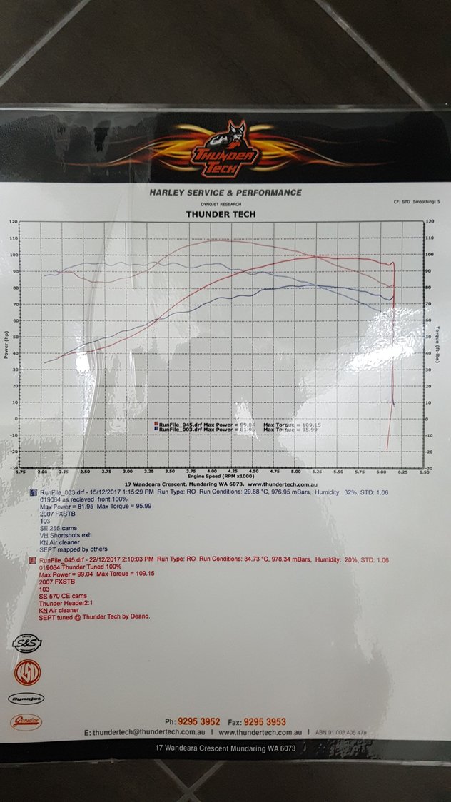

Spoke with new tuner after I moved locatioms, after looking at the bike he also recommended a cam change. I also managed to source a Thunderheader 2 into 1 for a good price.
Before:
103ci big bore kit
Manual compression releases
SE255 cams
V&H Short Shots
K n N filter behind the football
SEPST - Dynoed, pinging, timing pulled.
82HP and 96ft/lbs.
After:
103ci big bore kit
Manual compression releases, Not used now.
S&S 570 CE cams, easystart.
SEPST
Dyno 2.
No more pinging, woohoo.
