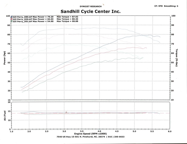

2011 heritage,stock with converter mufflers,next 2 inch baffle rush slip ons.no tune.last includes se 255 cams and tune.runs great!

ok,wrong chart this is the right one.
