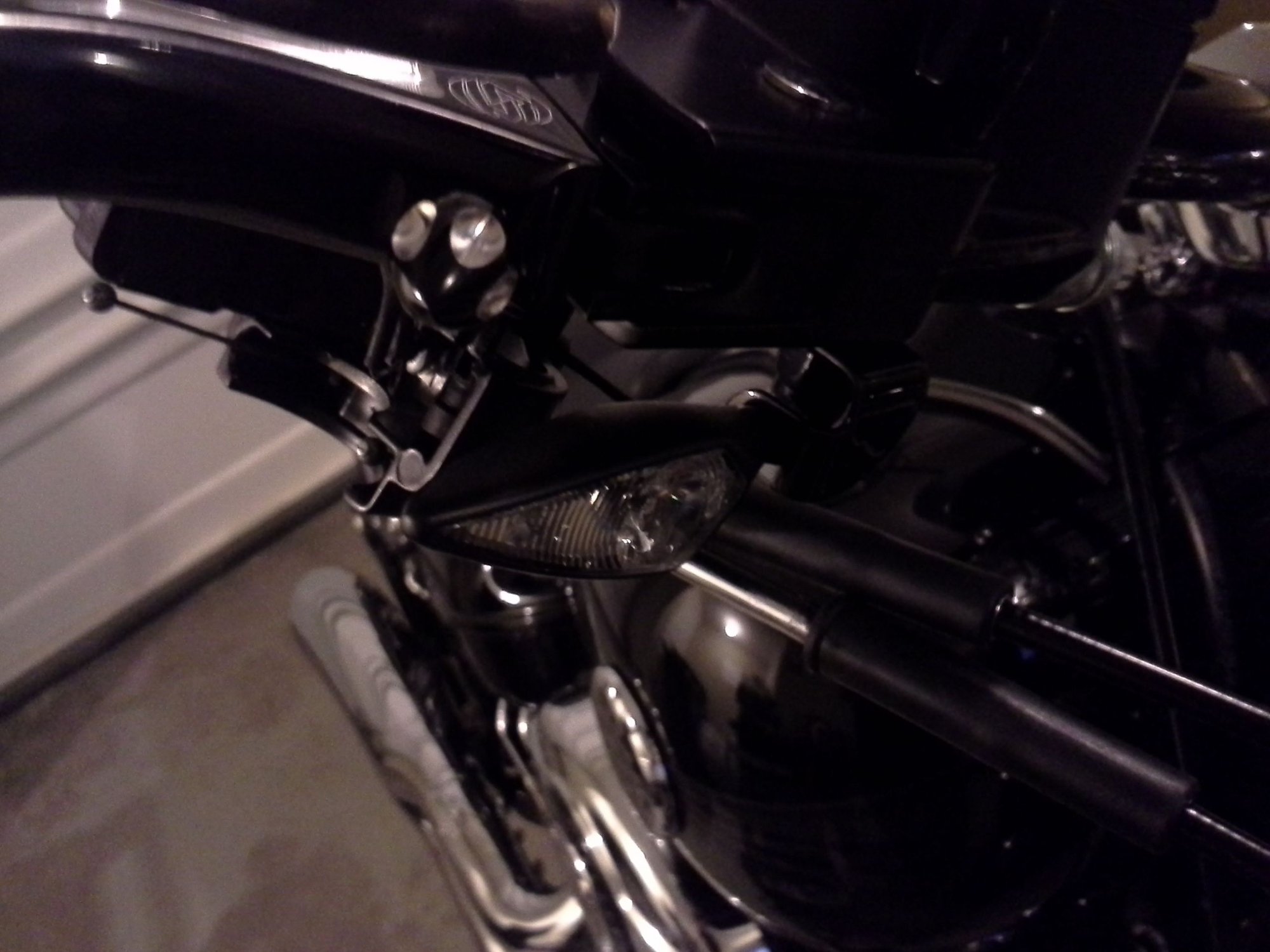

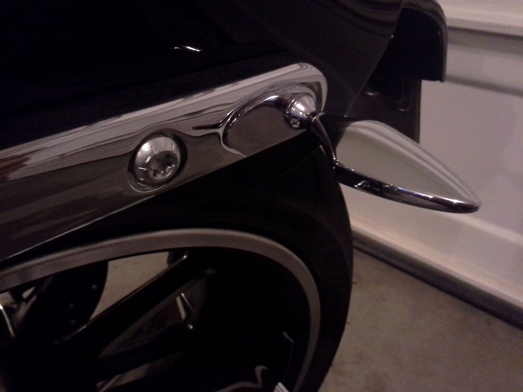

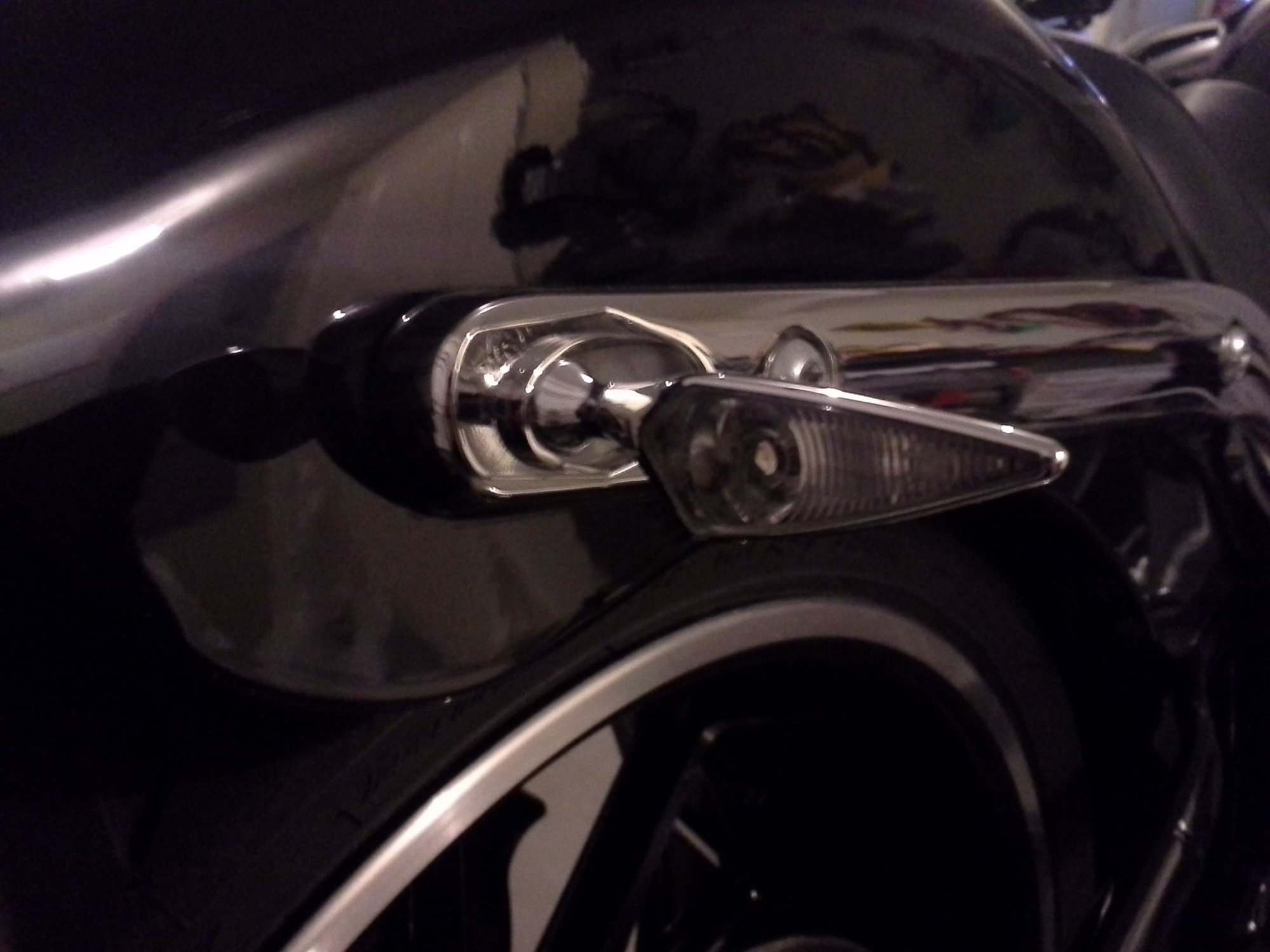

Are those Kellermann turn signals you got on the rear? I'd like to see some close-up pix of how you mounted them in the oval slots on the rear supports.

Thanks - do the oval base plates come with the Kellermann rear turns or are they a separate part item? looks like they fit pretty nicely.

The oval plates are "dyna recess plates", I'm having trouble finding them online but I know revzilla sells them, I bought locally.
The signals fit really well and the plates sit almost like they were made for this strut, gotta get the hard mounted shorter stems when you buy the signals though, they come with rubber mounts which is nice if you bump into them but looks significantly worse. You'll have to cut a couple threads off the stems to fit behind the struts too but other than that it all works out well.
For what it's worth I think they'd look really good on your bike, the rhombus ones would look right at home with the theme you've got going.
