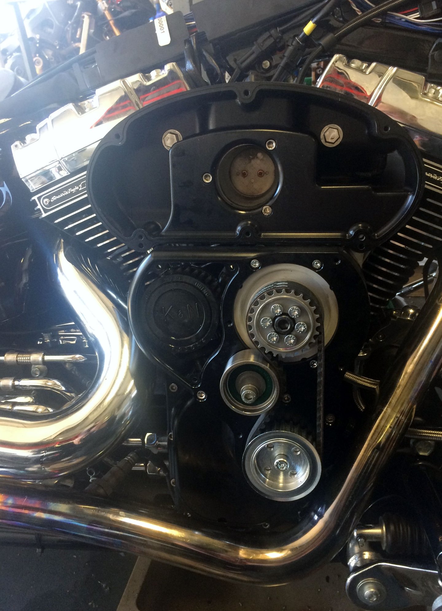

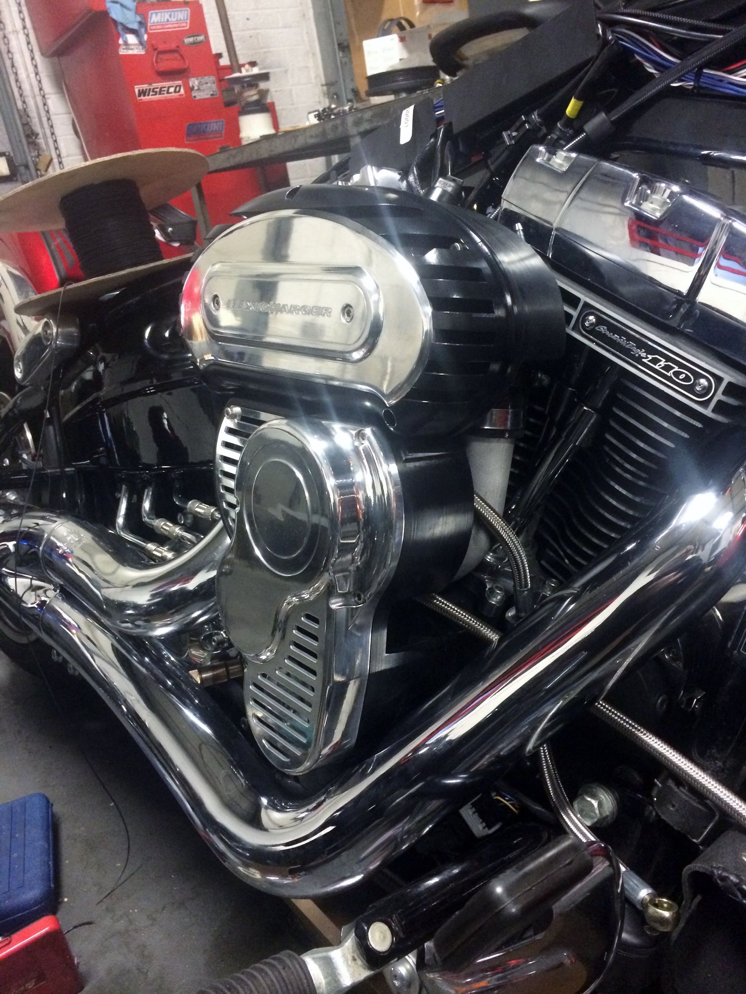

Well finally the Supercharger is being installed. We got bit delayed waiting for bigger injectors and also the Supercharger had to be slightly modifed for the 110 engine as it was originally designed for the 96 / 103 engine.
The tuning will then be completed on Tuesday on a Dyno and am hoping to have the bike on Wednesday.
As this supercharger is beltdriven centrifugal type then the boost gradually increases with Rpm. In order to get hight boost and torque at lower Rpm then the gearing of the supercharger has been slightly altered and the engine RPm will be limited to 5600 in order not to overspeed the supercharger.
I prefer low to midrange power rather than getting few more Hp at very high Rpm..
Here are pics of the installation.. will then post the dyno results on Tuesday
