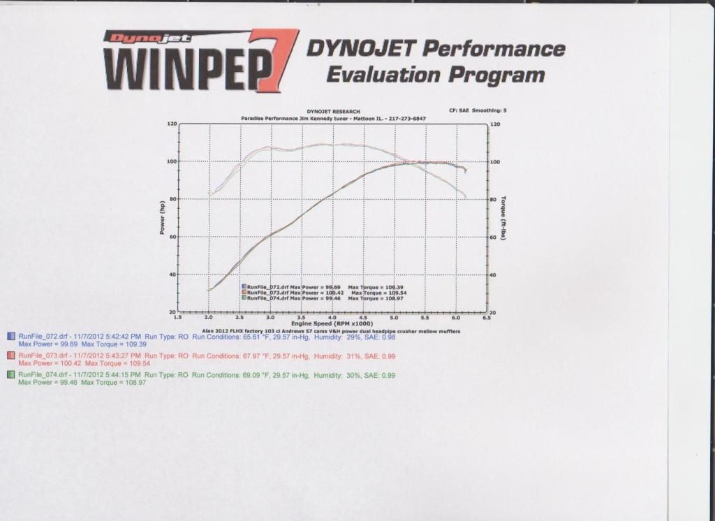

this is what I'd be shooting for with the 57h cams or similar. the chart below is from a 2012 103" softail with 57h cams, 2-1 pipes, A/C and good tune. so with my 2-2 more open pipes I'd probably see TQ numbers in the low to mid 90's.

Nice results EagleRay- I've looked at a lot of dyno charts for the SE204 vs 57H- both are virtually same- 57H comes on a couple hundred rpm higher and extends out a couple hundred rpm further, generally that's the main diff but it is nothing significant since both are strong in the important areas of typical riding RPM's. Either one will perform. For a 2007-up bike with stock belt pulleys I'd take the 204 over the 57h, having TQ come in a slight bit earlier would be beneficial to get those tall ratios moving sooner.
I know some guys care about having the TQ extended out to 6k but frankly I think 5k is the realistic every day riding limit. e.g. I'd rather have TQ come in fast and strong mid 2k, peak around mid 3k and then sustain till 5k vs a cam that comes on closer to 3k, peaks around mid 4k, and sustains to 6k.
