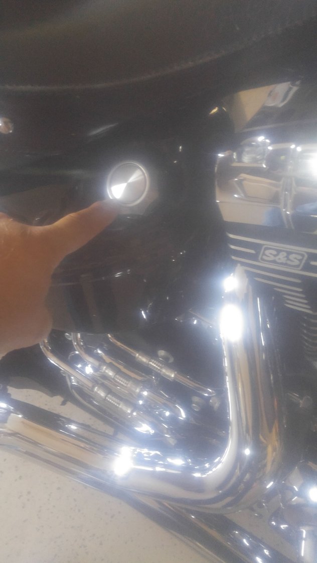

How do i check and fill the engine oil? What kind of oil is best for stage 5 110ci Harley Breakout?
Could someone please make video or post picture of where to check oil please
check the oil here, with the bike warmed up on the kickstand. Use any 20/50 synthetic vtwin oil you want. Btw, you add /fill oil here too.

Jessica: Check the user manual. There are some important details, like:
- Do it when the engine is at normal operating temperature, not when it has just been started, and certainly not when it has been sitting "off" for more than a few minutes (oil tends to drain back into the engine sump for an inaccurate reading)
- Wait 2 to 3 minutes after shutting the engine off. Do not do it sooner, nor significantly later than that
- Do NOT overfill!
- Clean the dipstick FIRST and then screw it back in to take the actual reading
If you want to make it MUCH easier, buy the HD accessory "digital" dipstick. With that, you simply wait the 2 or 3 minutes after shutting the engine off (e.g. after pumping gas), press a button, and it shows you both oil level and oil temperature without having to remove and replace the dipstick twice. Mine has worked reliably for about 4 years so far . . .
