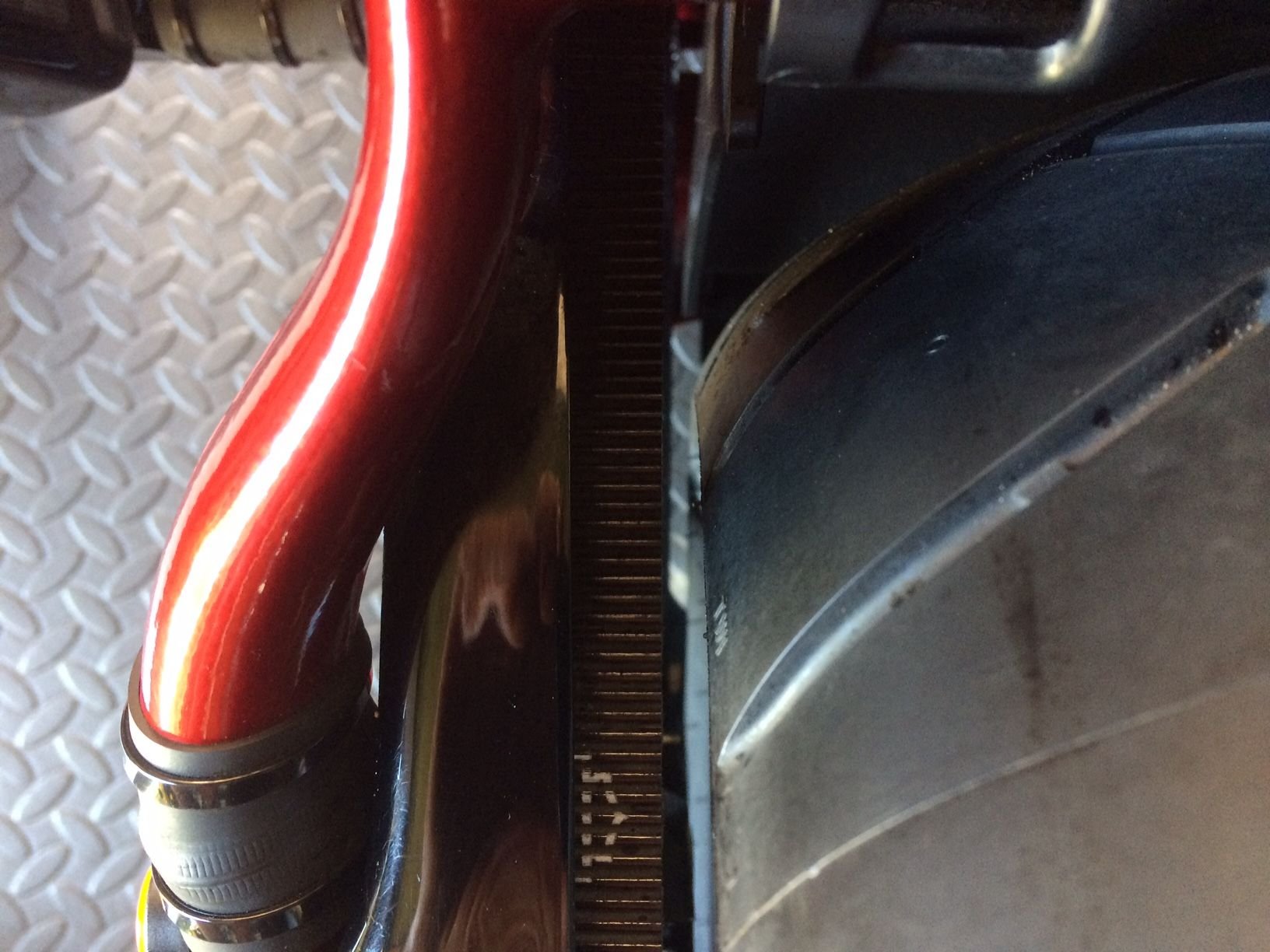

As others have said absolutely no issues whatsoever. I even took a photo of the tyre, oops sorry tire adjacent to the drivebelt. As you can see loads of room. Didn't bother having it balanced, I rode home and fitted three ounces of Dynamic Balancing Beads and it runs really smooth.

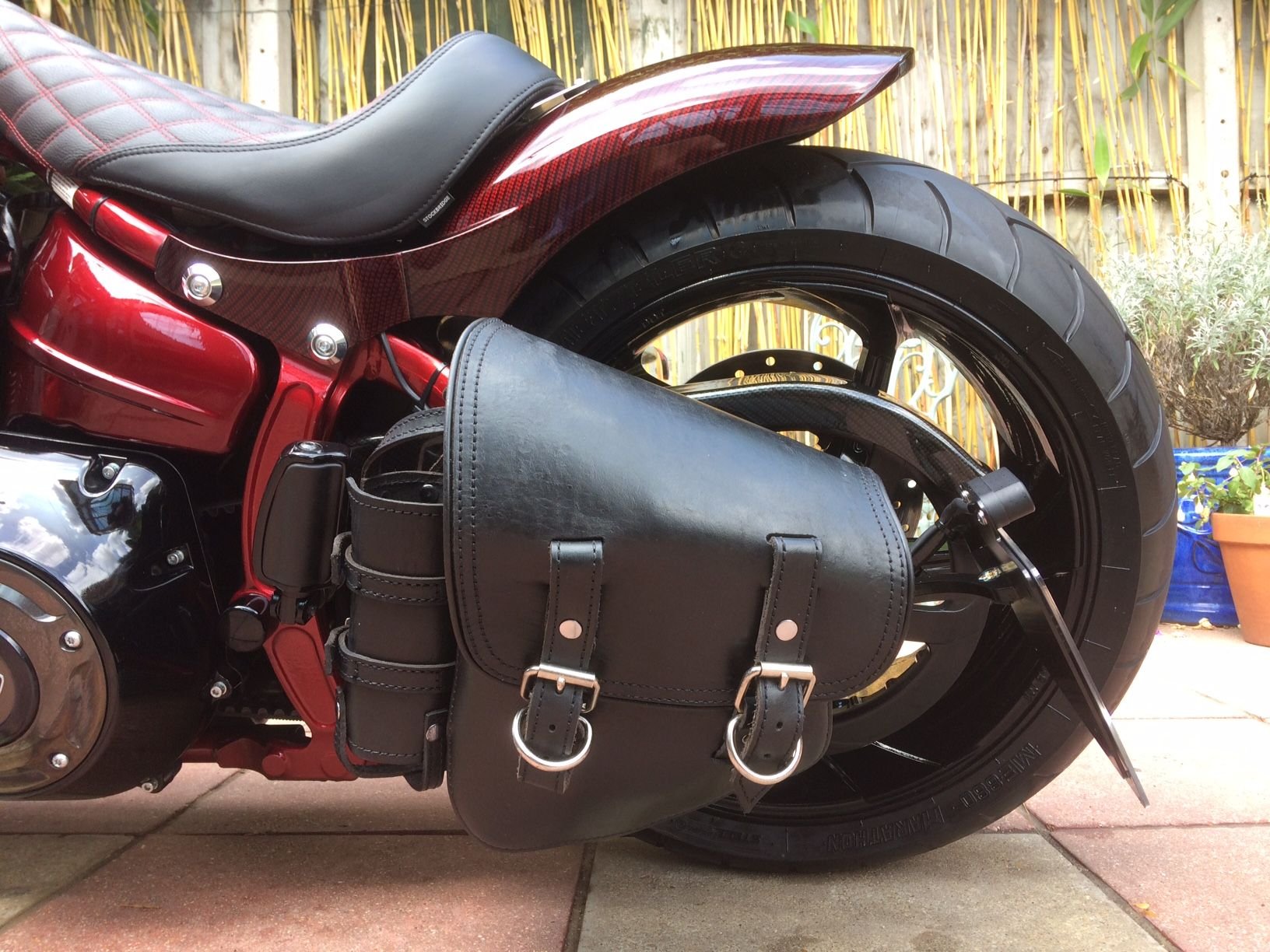

I was happy with it until I went to the Hamburg Harley Festival last June and returned with a 'Wishlist' of the latest ''Must-Haves' that I didn't really need. I swapped out rear fender for a Thunderbike one with the integrated rear turn and stop signals, had a custom seat made and fitted a Shotgun Shock.

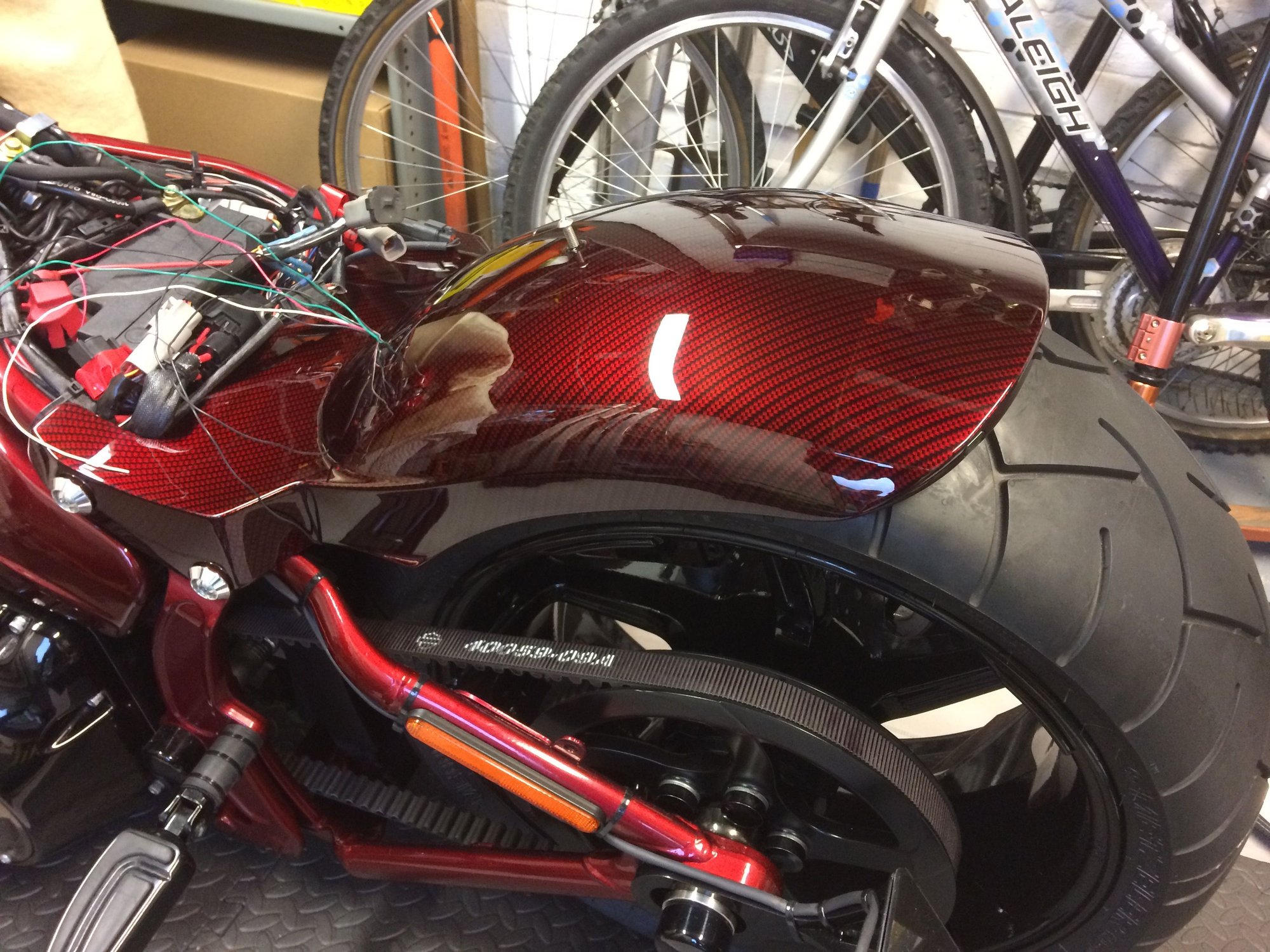

That paint is gorgeous!

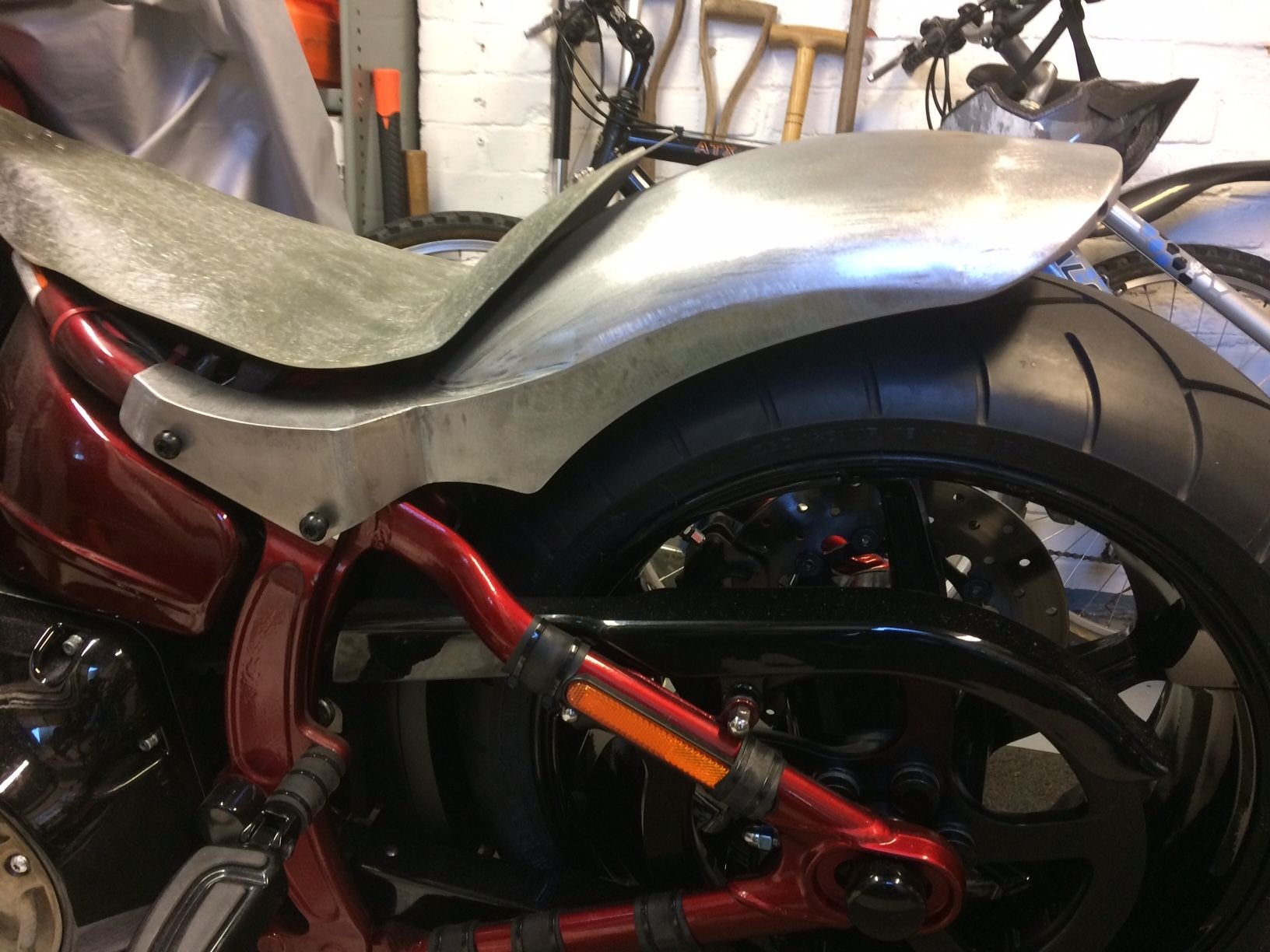

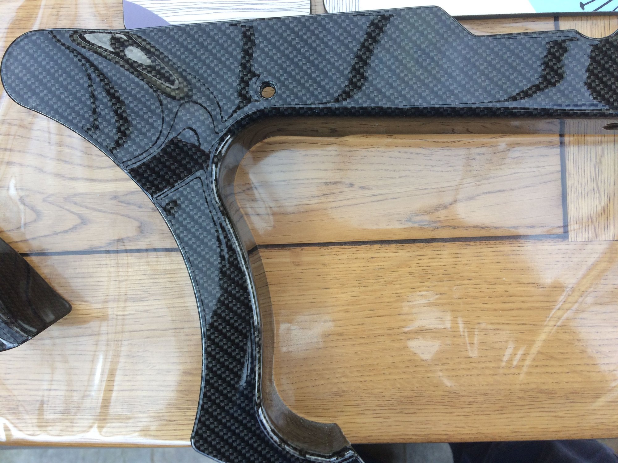

Thank you. The fender arrived bare steel. I was going to get the rear fender carbon wrapped but the cost was eye-wateringly expensive so I had it filled, sprayed anodised red then hydrographic 3D dipped with a carbon transfer then three coats of lacquer on top. I could theoretically have this process carried out 3-4 times if I want a colour change or style change for the same price as carbon wrap. I also had the two piece belt guard done in carbon black.
