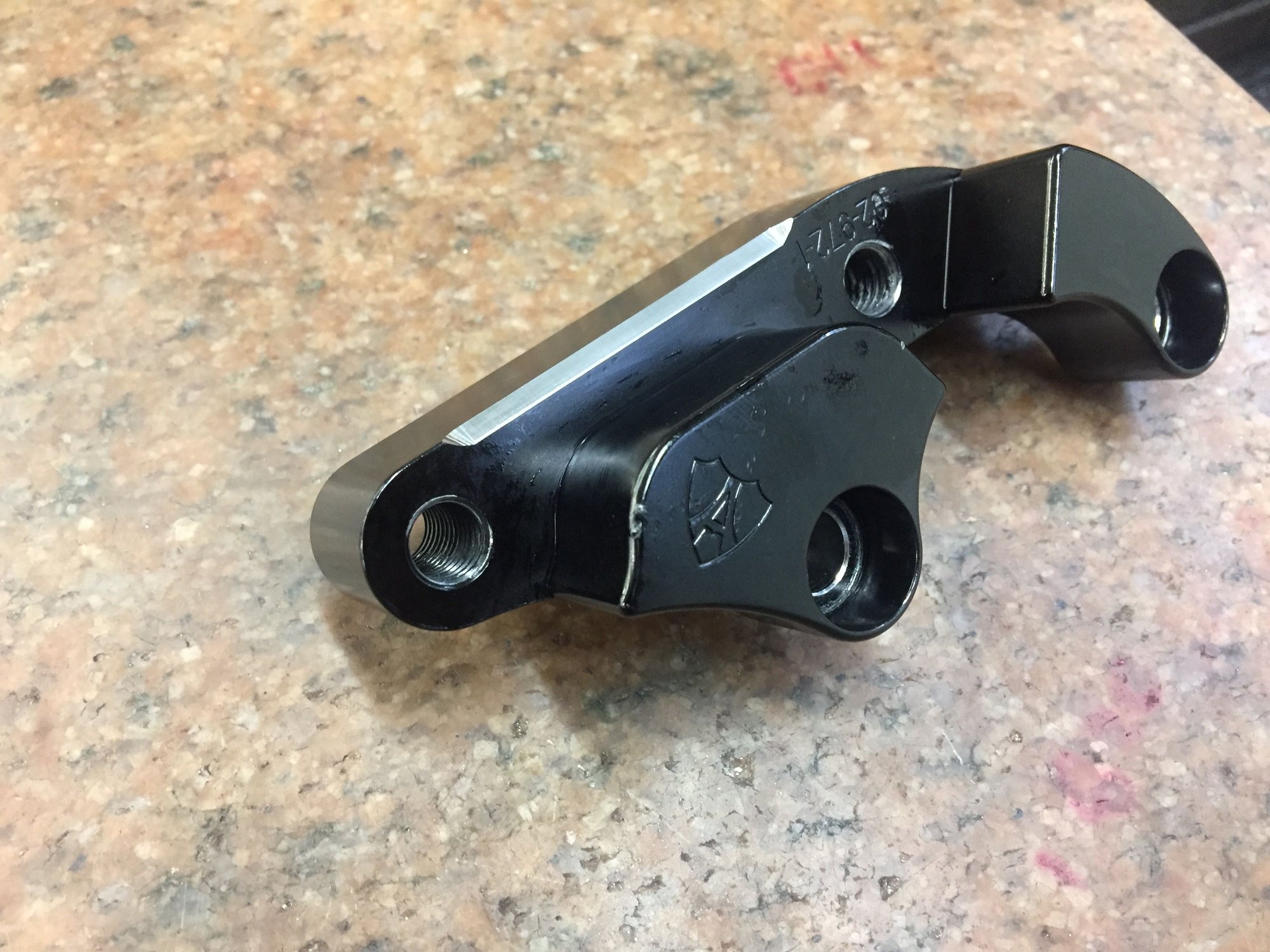

Old Oct 1, 2020 | 11:44 AM
  #7340
Breakout110's Avatar
Breakout110
Joined: Sep 2016
Posts: 153
Likes: 16
From: Chicago Burbs
Had to put a 45 on this edge to clear the fork leg kick out that has a small radi in the corner.
