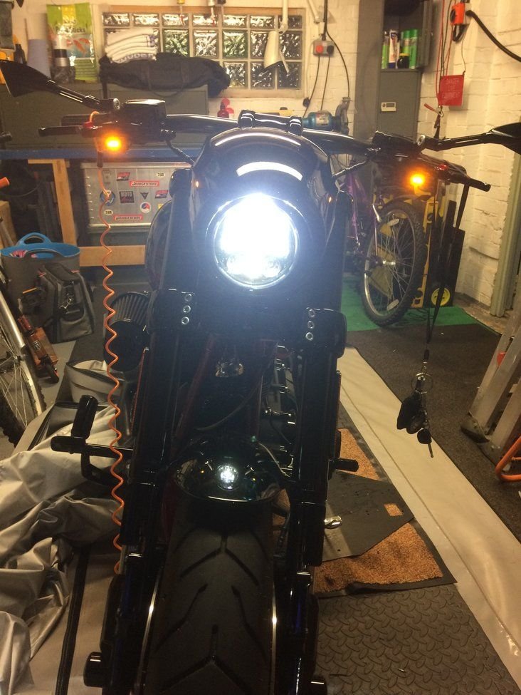

If you have CanBus you may need a load equalizer? I bought very similar ones from Thunderbike and to keep your instrument cluster indicator flashing at the correct speed an equalizer was needed. A single equalizer is needed for all four indicators on a non CanBus bike or two equalizers for a CanBus bike one for each pair of indicators front and rear respectively.
