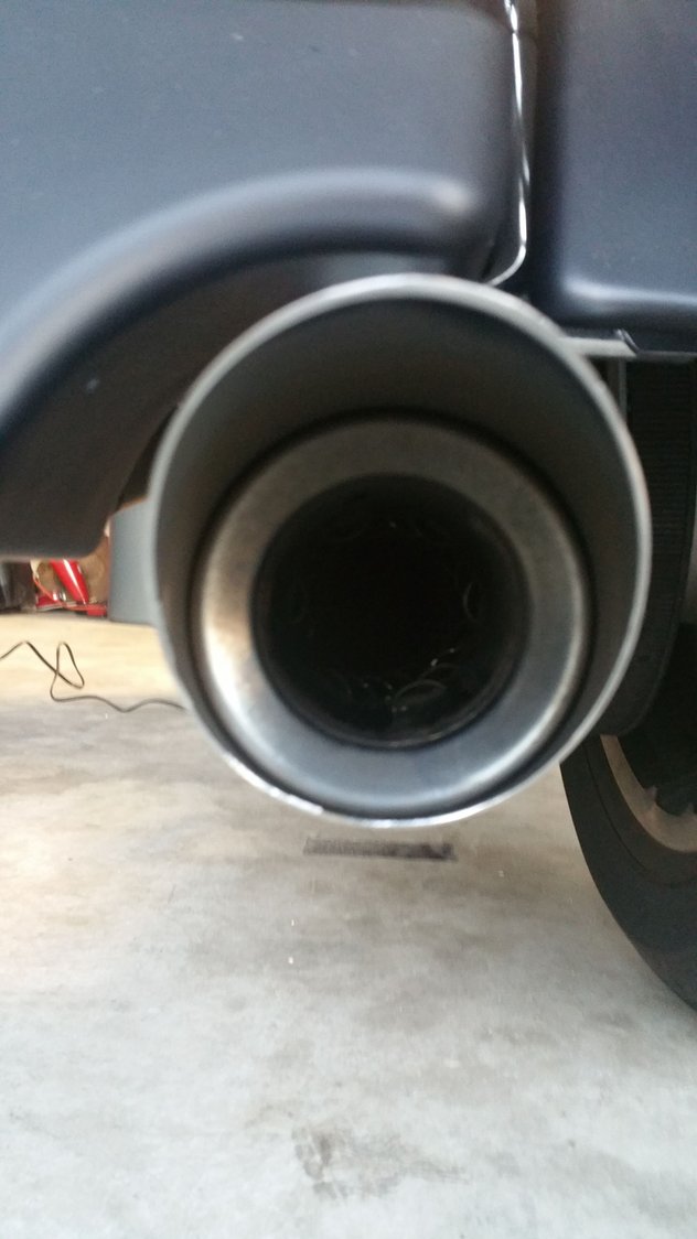

Trying to pull out the baffles on my python slip-ons, took the screws out but there is nothing to grip to pull them out. Any tips to help me get these things out?

A cheap tailpipe expander to grip the inside of the baffle. Tighten carefully, so as not to expand the baffle. Clamp Vise-grips on bolt and lightly tap out with hammer.

Look inside baffle and there should be holes to use a tool with a hook end to grab baffle and pull it out.

i push em out,pull the muffler,stick a broomstick in from the inlet side and use the muffler weight to hammer the stick on the floor.

remove muffler from bike so that any banging and pulling doesn;t stress the headers

This is the method I used after screwing with it for an hour.worked perfect and only took a few minutes!

Yeah, the broomstick worked for me, too.

What has helped me in the past is let the bike run a minute or two to heat things up and the pipes will expand allowing the baffles to come out easy.
