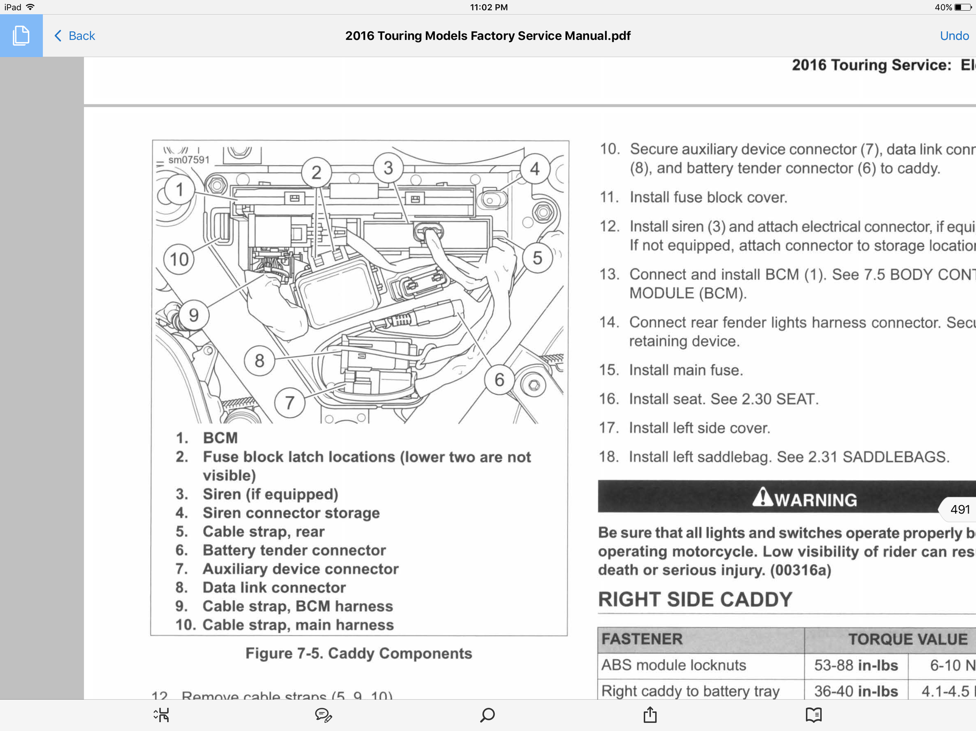

Have you checked under the left side cover for the the accessory connector? If I remember right, it has 3 wires (ground, constant hot, switched hot) and you can get a connector with the leads coming off, that plugs into it if you don’t want to “splice” into the harness. #7 on the picture...
