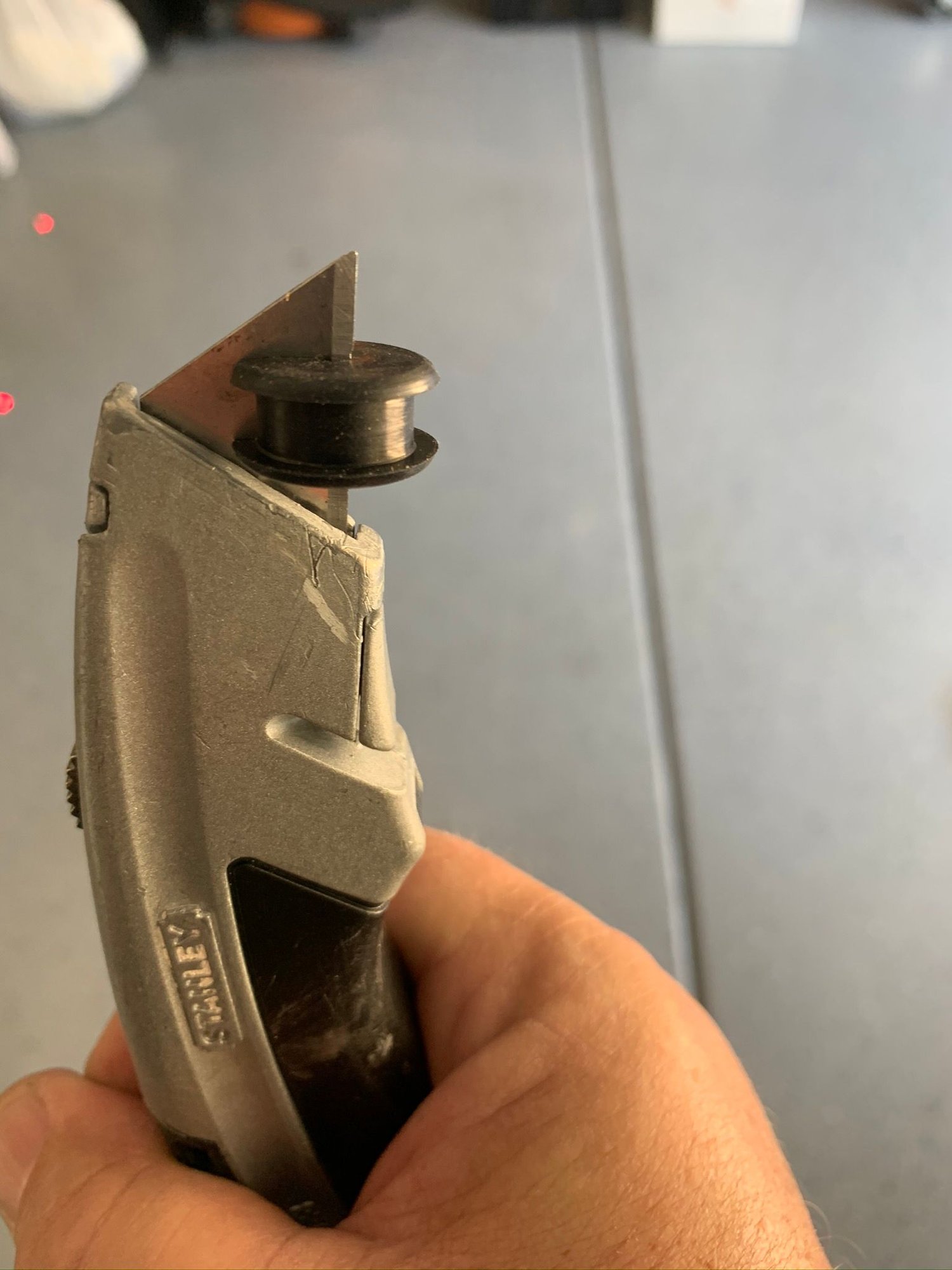

- slit the grommet from the center to the outside, to slide the wires in. Otherwise it’s a PITA/impossible to get the terminated wires through the grommet hole. Per the following picture:

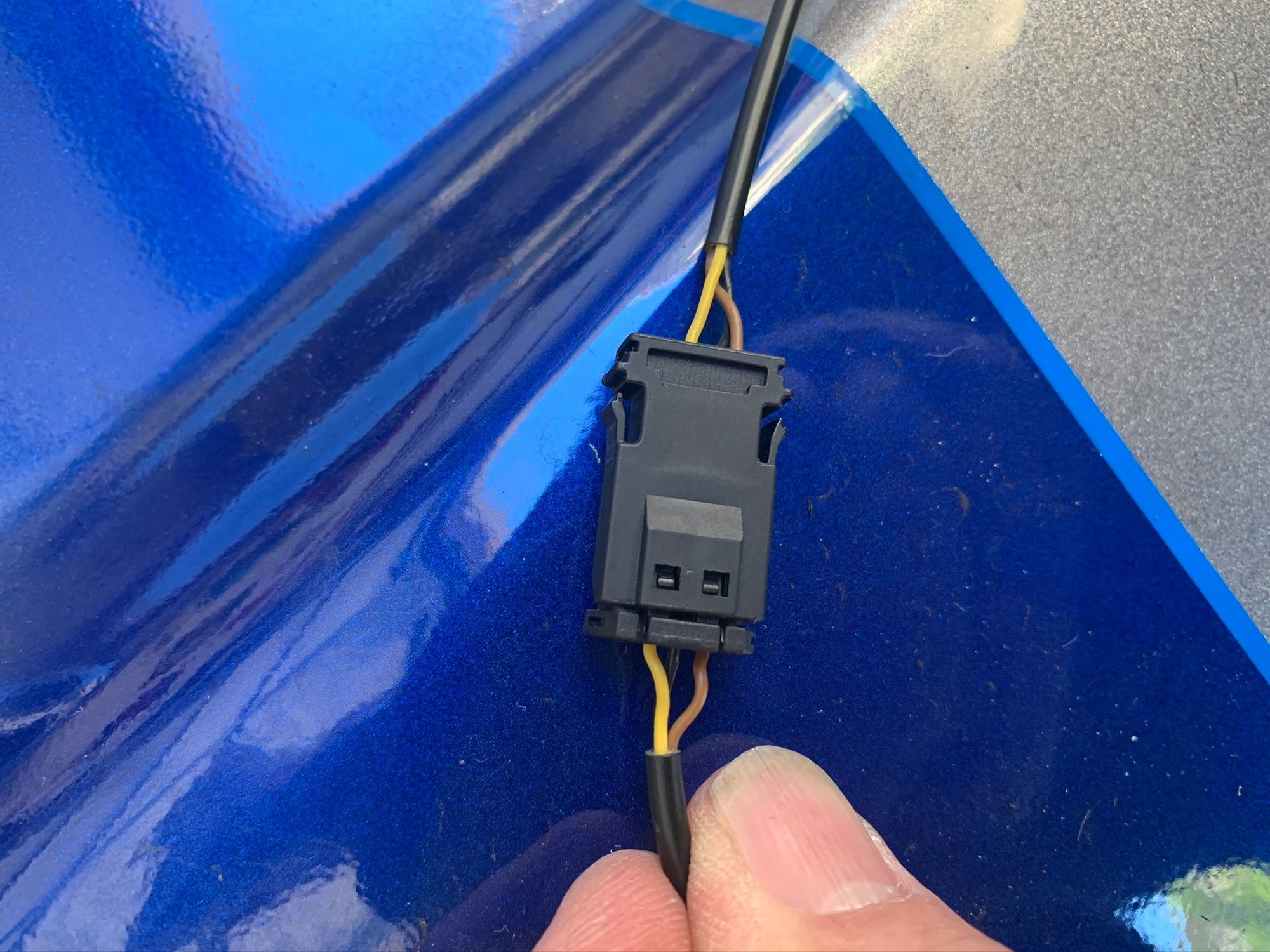

- once you get the wires through the grommet, you have to insert the terminated wires into a provided connector. If you have big paws like me, this is a PITA. The wires are probably 24 gauge with correspondingly small terminals, that need to be inserted into the connector until they they snap in place. A very thin punch helps to get them seated. I used the back of a sewing needle...and poked myself pretty good. Per the following picture, the termination side of the terminal goes “up” towards the latch. Also, it’s helpful to align both connectors to get the colors aligned properly...

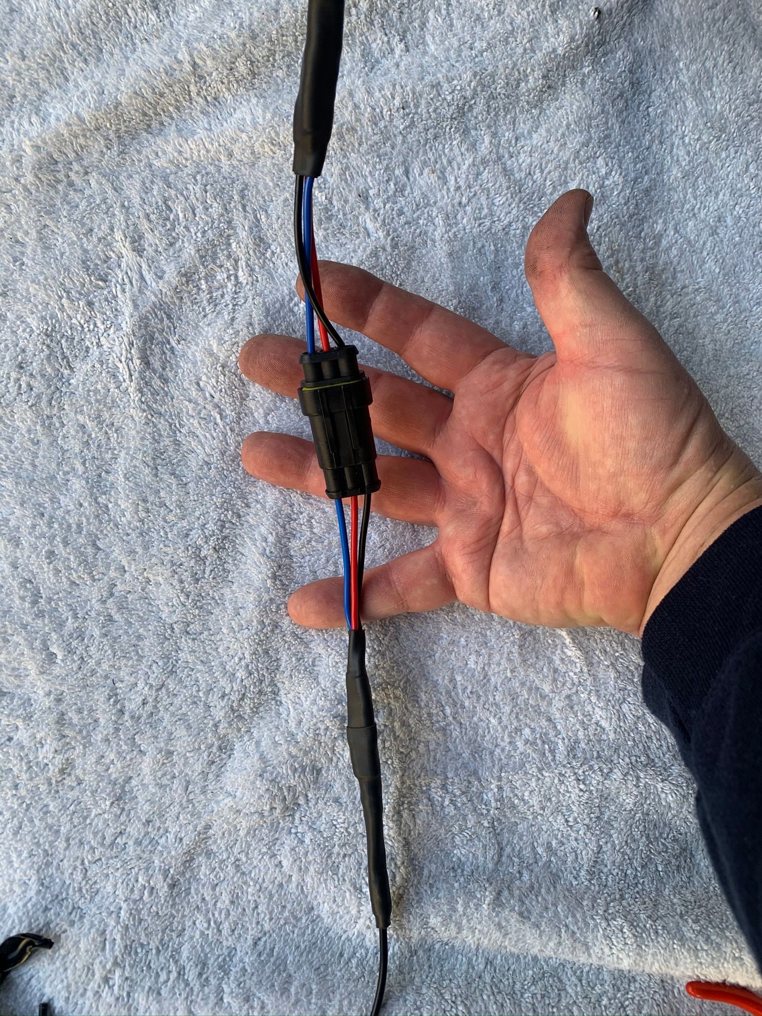

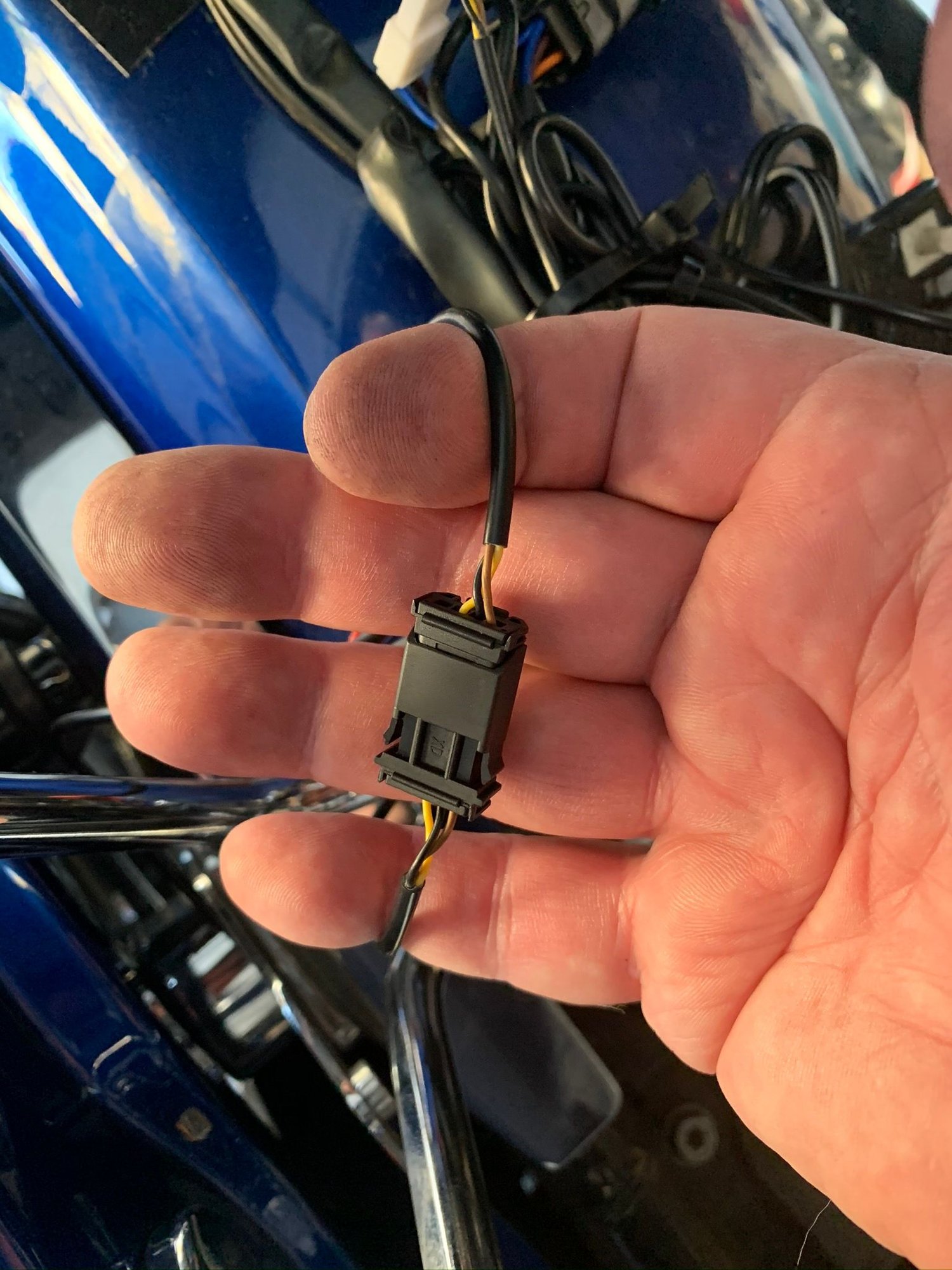

This is the connector that needs to be disconnected to remove the saddle bag. And as luck has it...I screwed on with my big paws, After everything was installed I had to remove the left bag to install the side cover...that I previously forgot to install. IMHO, this connector is just too feeble for this role. To fix the issue on the side I screwed up, I spliced in a heavier duty waterproof connector set that I had in my inventory. I reordered some to do the other side. Following is the provided connector, then the connector I spliced in place.
