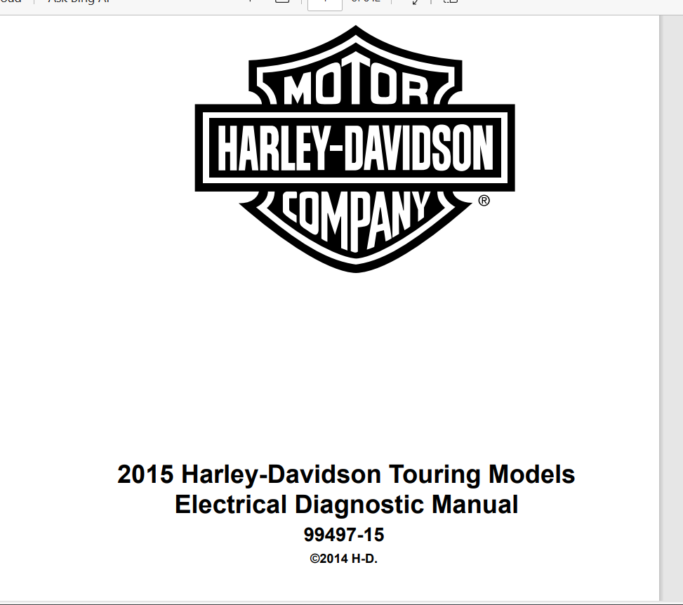

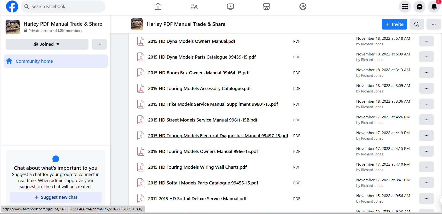

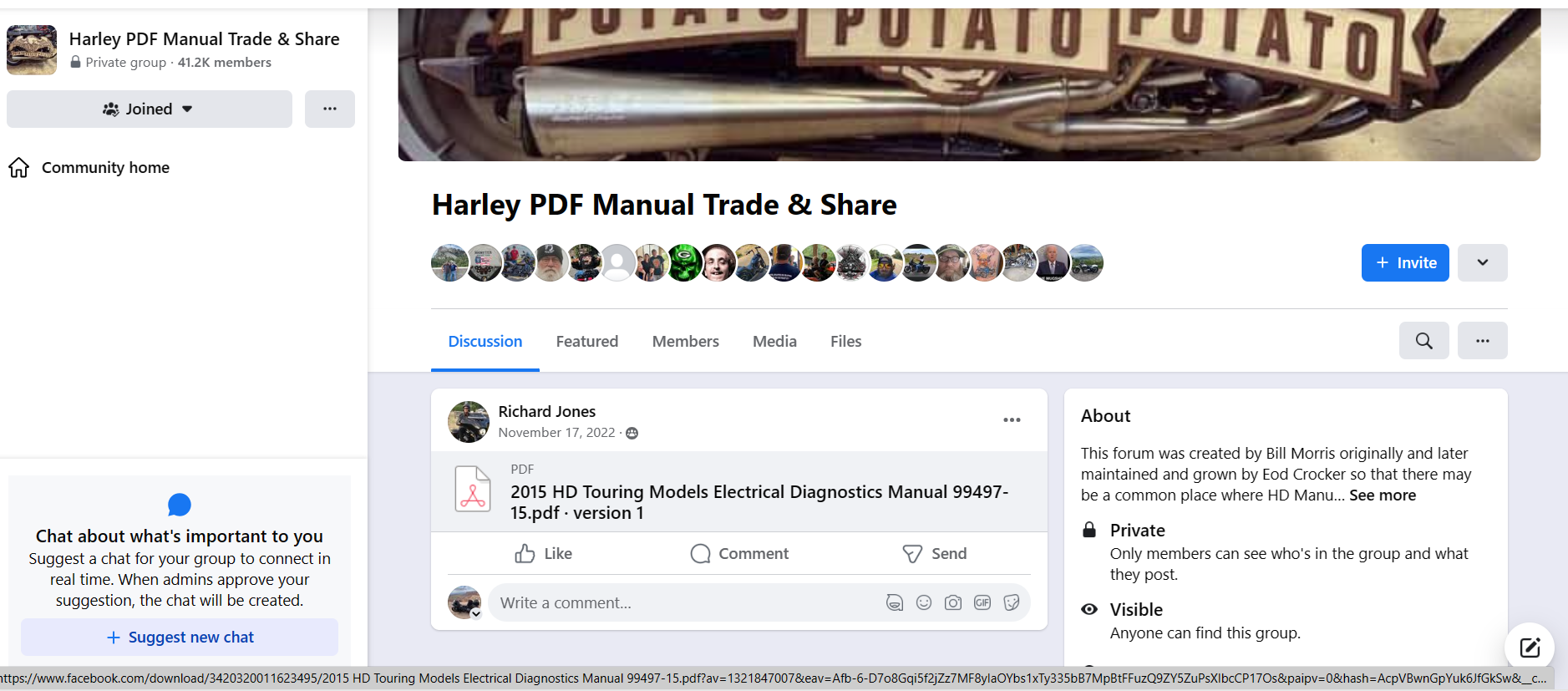

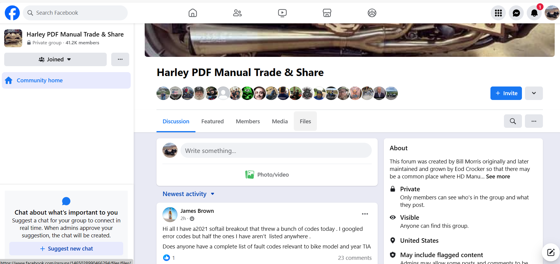

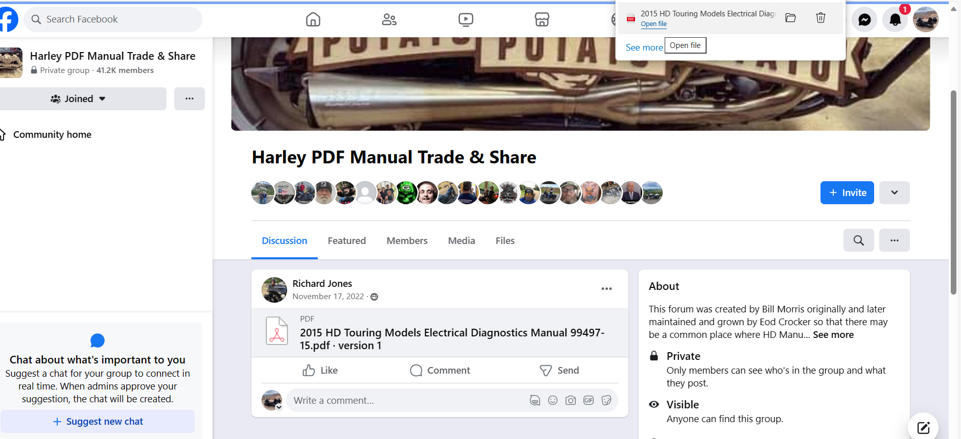

Harley PDF Manual Trade & Share is a Face Book group. Join the group and click on Files - type in 2015 - scroll down to Electrical Diagnostic Manual - click on the manual link and download it to your hard drive.
The Manual provides a description of the bikes electrical systems and step by step trouble shooting guides for DTC's. It may not always pinpoint the problem, but it will help eliminate components that are suspect.
