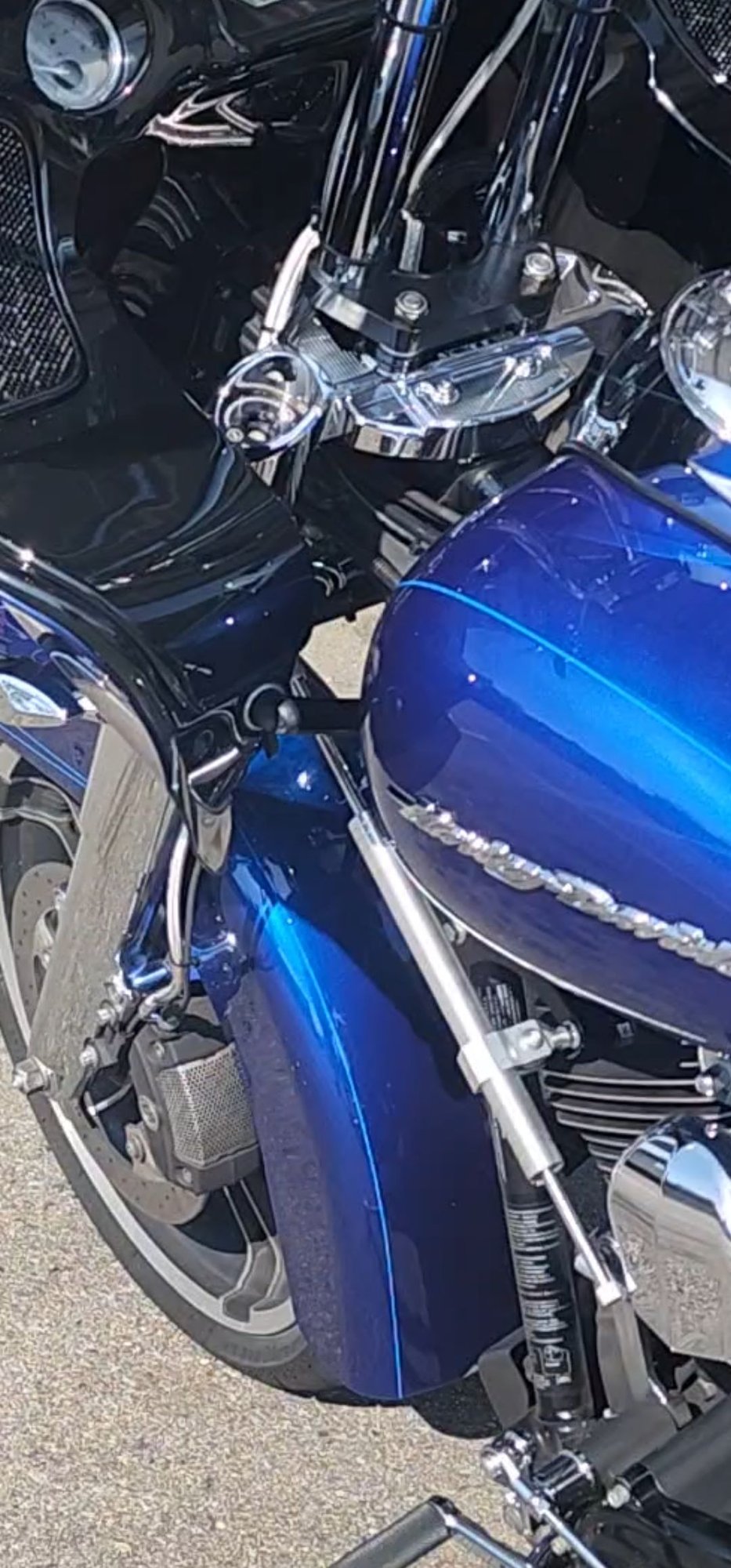

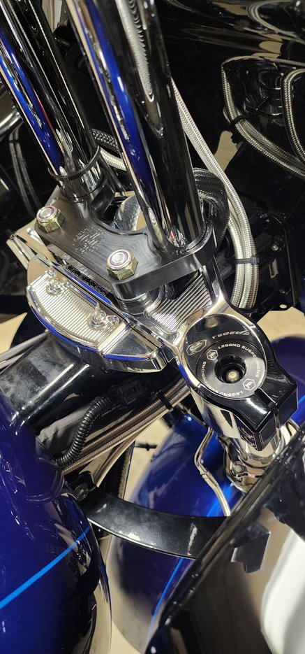

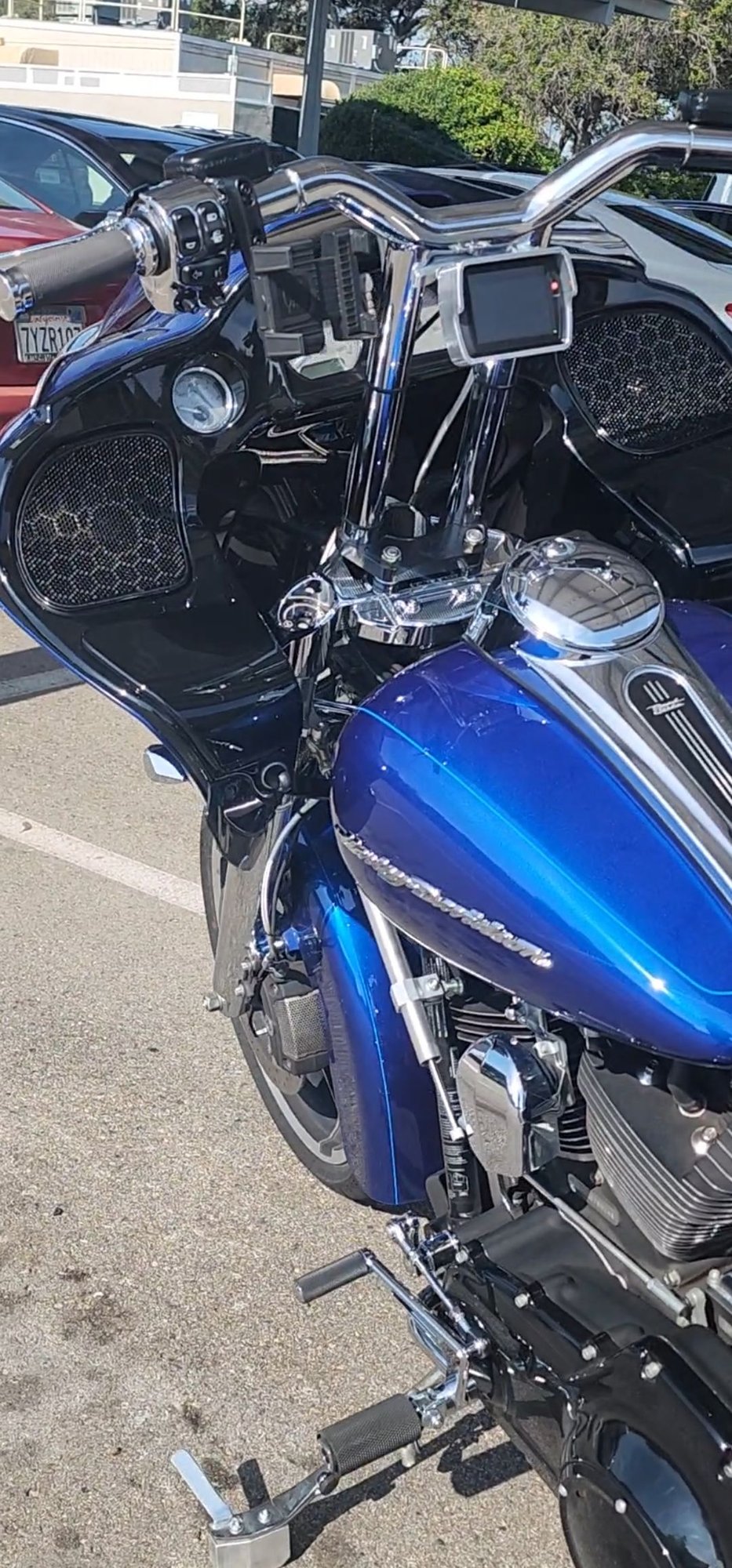

I have one. It's to prevent any high speed action just like another other fast paced motorcycle on the market has or can be installed.
im 4 over suspension in front from 2+ tubes and cartridges with +2 drop trees in concunjtion with 14.25 rear shocks. I mounts under lower triple tree and bolts to left side of frame legs.
Steering dampner most definitely makes the ride better if your really getting after it with heavy lean angles on a big *** bike. I also have solid rear isolators installed so it locks my swingarm in place with mo more wiggle from the crappy harley rear isolators.
my dampner is not to band aid anything. . Just to have a proper set up.
you may need to look up "the missing link" and buy it, then get your motor/chassis aligned.
21" up front without suspension, alignment and such could definitely be making funky responses in the riding experience. It also could be a loose rear eyelet or over tightened rear shock. Miss matched tire treads etc.

Your bike is badass , you got a link to that stabilizer.
Old Feb 22, 2024 | 02:40 PM
foxtrapper's Avatar
foxtrapper
Veteran: National Guard
Joined: Nov 2012
Posts: 6,186
Likes: 2,412
Looks like a Twin Power damper.
​​​​​​https://www.jpcycles.com/product/twi...ku_id=10067755
