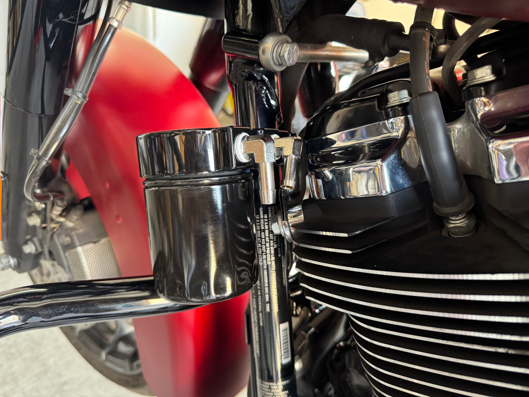

Originally Posted by Bproctor
While installing this oil filter relocation kit I had to remove my chopped crash bars in order for it to work
I want to order a different set of crash bars, but want something that looks good and will not interfere with the oil filter.
I don't want the standard Harley crash bars, and was hoping for some suggestions. It's for a 23 street glide.
Originally Posted by 702
The downtube kit doesn't work with the chopped engine guard on a Street Glide?
Well ****, I just ordered this kit.
@DK Custom Products Is this true?
Originally Posted by YZR
Call them, they are good people to deal with.
Before I do, I'll wait until I receive it and see if it fits or not. I thought perhaps a response from them here is appropriate and then we'd all know, but if they don't respond I'll be able to answer the question for all of us in a week or so.
It's a tight fit, but it works just fine with the chopped engine guard.

I am going to have to do this, now that I can see that it is possible with the chopped guard. I am sick of removing the True Track every single time to change the filter.
Thank you @702 !
