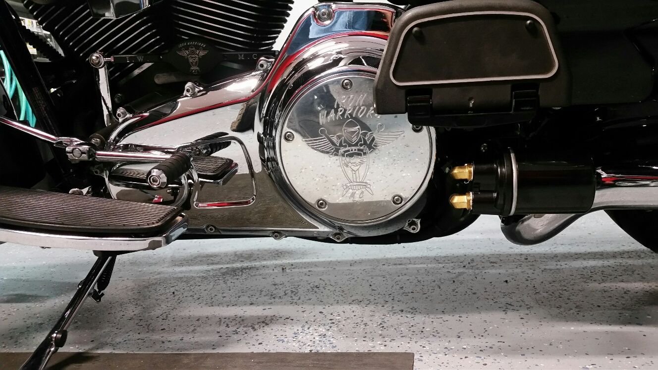

Have around 10,000 miles with this one on my softail. Haven't noticed any engine problems yet.
