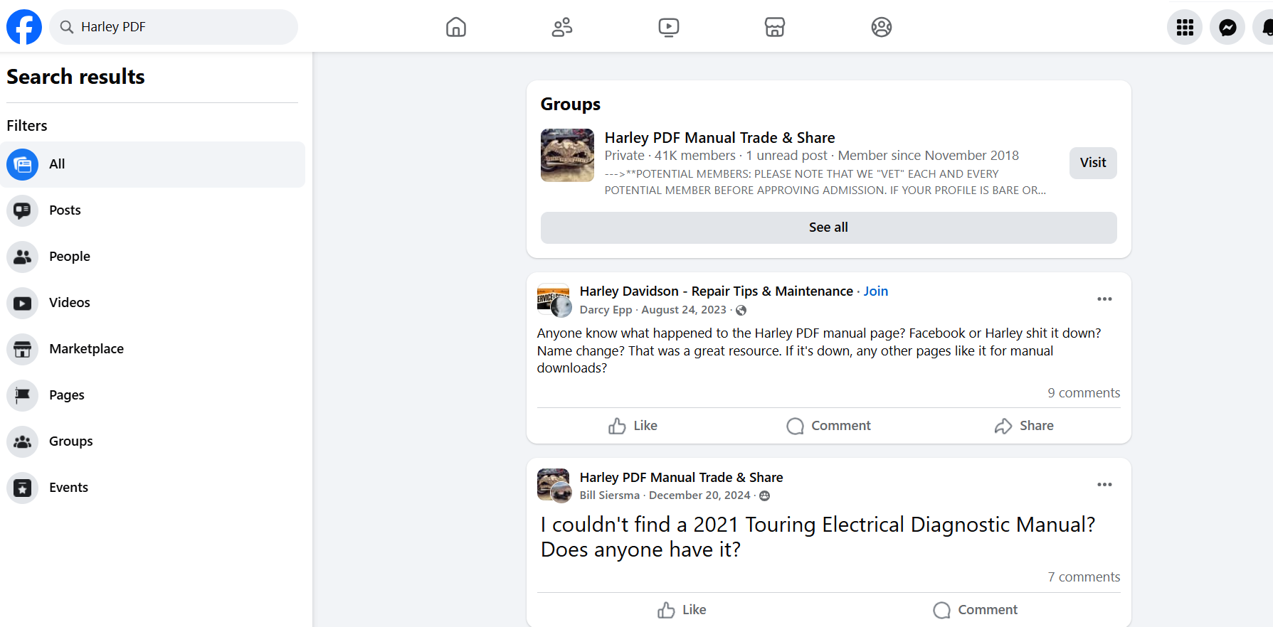

Originally Posted by Vernal
@dwhit6419
Go to facebook and join this group: Click on files and type in the year of your bike. Scroll down and find an Electrical diagnostic manual and copy it to your hard drive.
I made the write up below as something easy to reference. Hope it helps.
*snip*
Is that a non-discoverable group? Facebook search does not find this group.

@Goose_NC I just did a search for Harley PDF and the site comes right up.
