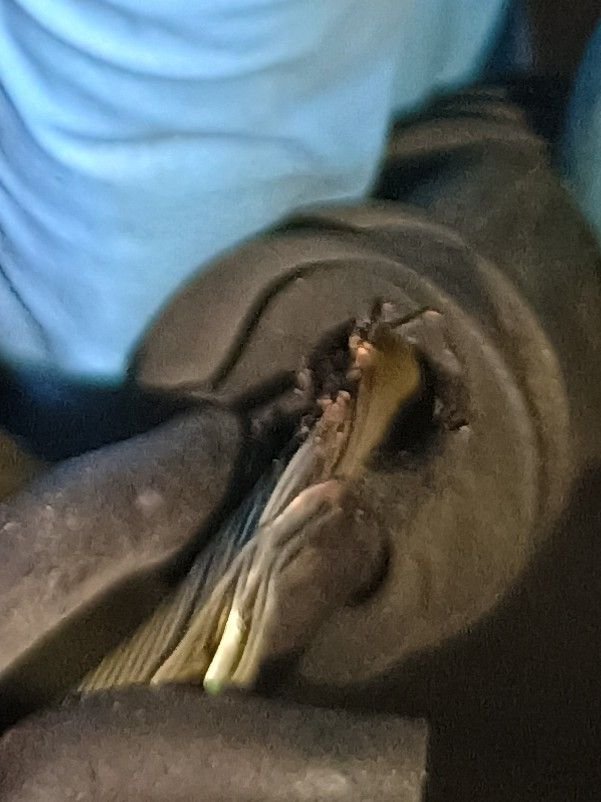

Got all the service manuals, but would like to get the official electrical manual.
OP there's a trick I have done a time or two in a pinch that might be worth a try. If the internal wire is cut through, you could carefully peel the insulation back and dig into the plug a little bit, then soak each end of the wire with flux, push them together and get someone to hold them. Then apply solder and the flux will cause it to run up the wires in both directions. Hold it still and blow on it to cool it solid. If it is a good solder joint you could encase it in some epoxy (light coat), then apply silicone. Once done it's up to you if you feel like it is secure or not.

So I have a question about my stator cable. Does that need to have NO broken wires to work properly?

So after further review this is what I come up with.

My connector frayed. I think had some making contact, can't remember, I got a battery light on dash and check engine light for low voltage, I was about 13-14 miles from home, decided to head for home. Was nervous. Made it.
Harley sells the end and about 18" of wire that you need to cut and connect.

You don't happen to know a part number for that do you. I had looked a week or two ago and didn't see anything like that.
