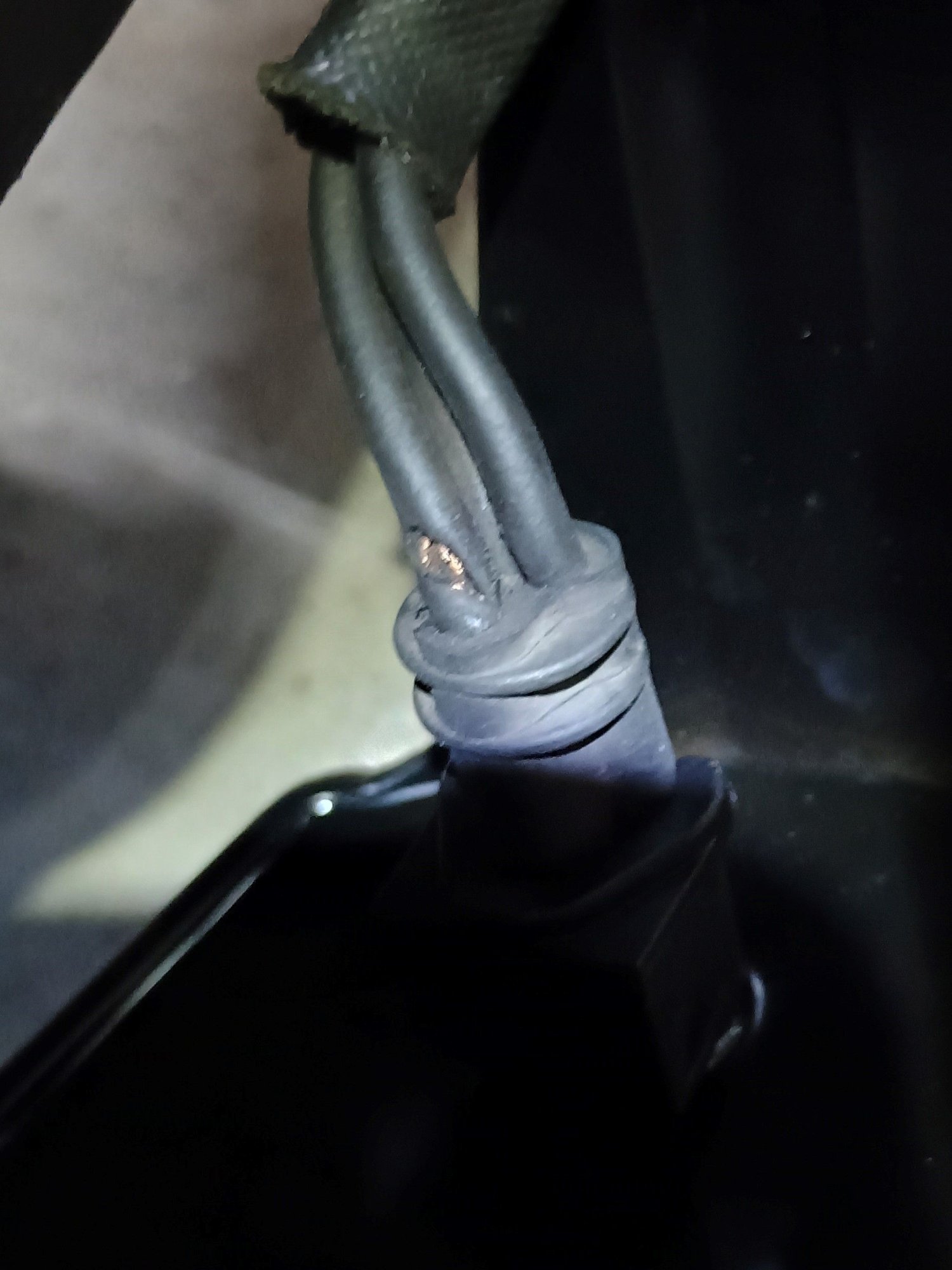

So this morning before work I took another look at the stator wire and found this. I can't believe I missed it. Is this enough to create what I've been fighting? Does it mean replace the stator, or tape it up and run it? I think I know, but...

Depends if the wires inside are intact, frayed, broken, or corroded.
Me, I would use a pick and pull the outside casing out a bit and inspect to see if the inner insulation is intact. If all looked good, I would clean it good, put a spot of good silicone RTV where it is broken, use some good electrical tape over the RTV and tape it up, then run it to see how it behaves.

OP that sure ain't good. That wire looks like it is frayed or dang near cut in two under the insulation. Hard to tell for sure. I battled a similar problem with a regulator wire like that on my shovelhead many years ago. It would run fine for a while then quit charging. I guess what you could do is put your volt meter leads on the battery terminals with some alligator clips, crank the bike then gently move that wire to see if the voltage changes. If it comes and goes it MIGHT be possible to patch that wire with a good solder job, but you would have to carefully dig down into the strain relief to get enough wire to work with. That cut is in an awful bad spot.

Yes, being so close to the plug is not good. When I open it up and clean it out we'll see how bad it is. Most likely new stator time as I sure you can't just change the wire out.

I wonder if you can buy just the socket and pigtail and splice? It would be nice to just change the socket only, but that's probably asking too much.

Nope. Sucks and that plugs is prone to leaking.
For once I agree. Again I would charge battery and see if everything is good until battery gets low.
