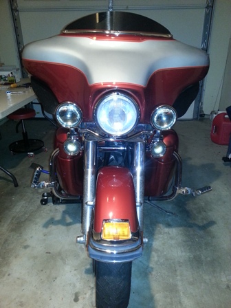

Here's my '99 Ultra finished. I went with the 12" MBB's and the LA Choppers cable kit for 12"-14" bars. The clutch cable is an inch or two too long, but sits just fine. Speaking of, I had to throw in the towel on that one and take it to an indy and let them run the cable for me because the old one was a b*tch to get out. Not bad on the wallet though, only about 1 hr labor. Throttle cables were easy as well as the brake lines...and this is coming from a first timer at doing this. Running the electrical through the bars wasn't as bad as I thought it would be either. If you do it, just make sure you push before you pull.
Anyway, here are a couple of pics. Hopefully I can get the before and after to upload.
BTW, the position feels great...but slow turns are taking a lot of getting used to.
Here's the before...
Attached Thumbnails Monkey Bagger Bars with Pics (Install)-20130115_194225b.jpg   Monkey Bagger Bars with Pics (Install)-20130115_194358b.jpg   Monkey Bagger Bars with Pics (Install)-bars-beforeb.jpg
