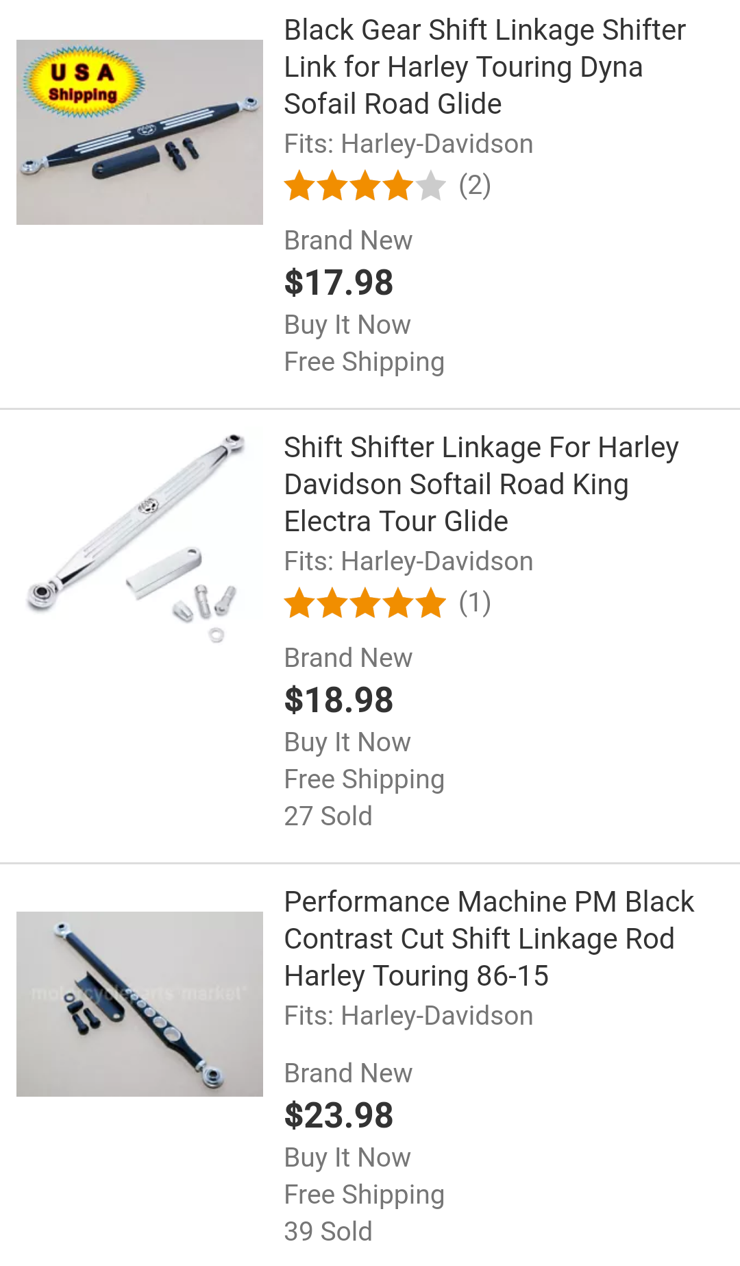

There are tons of shift linkages on ebay. Over 2 years ago I bought a $25 unit with heim joints, polished Harley logo. Still works just fine. No need to buy joints and build your own unless that's what you're into.
Just a couple examples...
