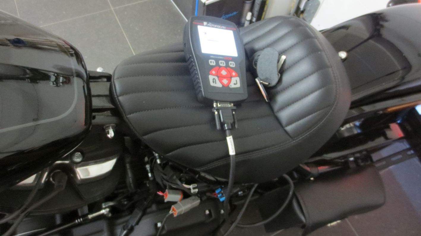

I did the install and programming from the CC in less then 30min ( each ) on a FXBB, FXFBS and FXSB.

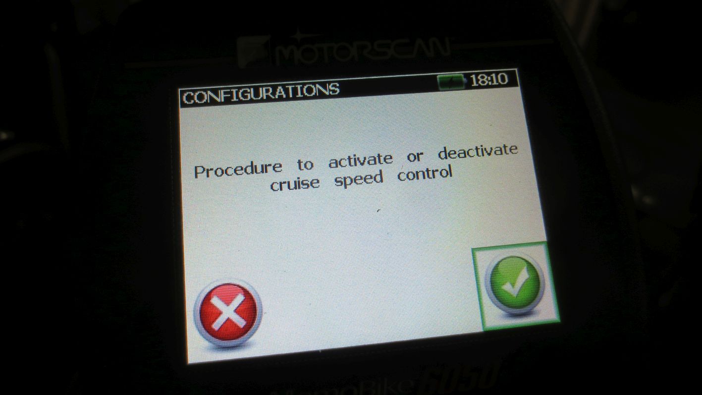

The programming of the CC
**** dude, that’s amazing. I wish you lived close to me. Haha. Ok, I’m going to take mine to Harley and hopefully they don’t try to charge me 3 hrs labor as they estimated. Thanks for your response
it's super easy to install... just an easy swap/plug and play.
then you can bring it in, and they'll likely turn it on for free (they did for me), or maybe charge you a 1/2 hour labor. You'll thank yourself, and also learn something about your bike.
What tool is that you are using to program?
Old Nov 6, 2020 | 01:22 AM
  #1049
MoneyFor's Avatar
MoneyFor
Joined: Feb 2017
Posts: 2,583
Likes: 1,029
From: East Flanders - Belgium
Motorscan Memobike 6050 Diagnostic scan tool, I can do everything what a HD dealer can with this tool. I also have licenses for , Harley, Honda, Suzuki , Yamaha, Ducati and Can-Am.
You can buy a license for every brand on the market and then you can do what the dealer can.
