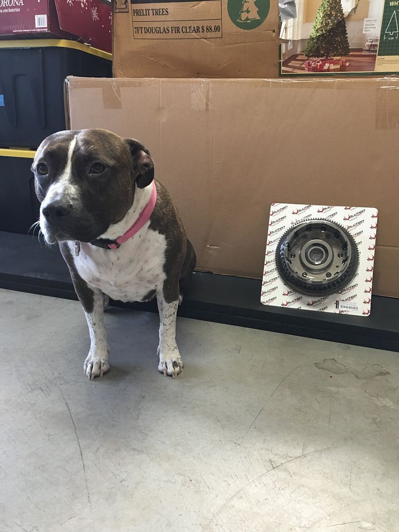

Hey suede I figured I'd let throw you a dog pic for your thread on Christmas.. Dyna doesn't seem as excited about my Christmas present (to myself) as I am.. Merry Christmas buddy!
Good pic Man, and Merry Christmas back at ya Yeah, he doesn't seem to impressed with it
Are you putting it in this weekend?

I don't remember seeing the pre installed bearing option with tha Evo, probable cheaper too....
