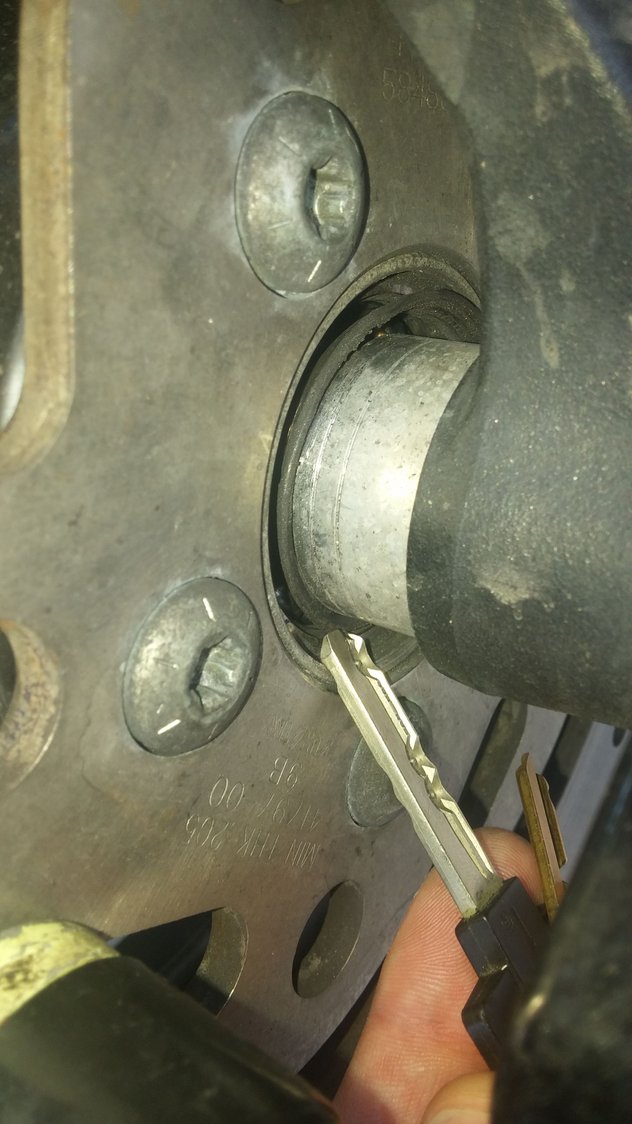

So the last week or so ive been hearing a small squeel when im in low speed or just dragging the bike by foot to not wake the building and i think i found the cause
The O ring that im pointing at with my key. My guess is this is suppose to be attatched to something right? Because that thing is completely loose...

Looks like seal over bearing has let go. Squeak would come from worn our bearing, or maybe disc brake dragging.

Bearing squeal... time for new bearings. Mine did the same.

Mine squeaked for a little bit then the bearing collapsed.

All the ops above have said it, the bearing is toast, change straight away do not wait anymore.

that bushing is installed wrong,the lines should go to the outside!

Well thanks for the help everyone!
ill get it fixed monday, any ideas on how much the wallet damage gonna be?

If you pull the wheel yourself, you can probably limit the cost to 1/2 hr of labor +parts...
