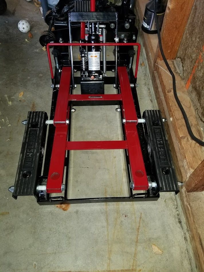

I purchased my jack for $73 on sale and spent another 20 in hardware. Got the mod done today and had to test it out...works great! Thanks SC Longhair for the great thread!
