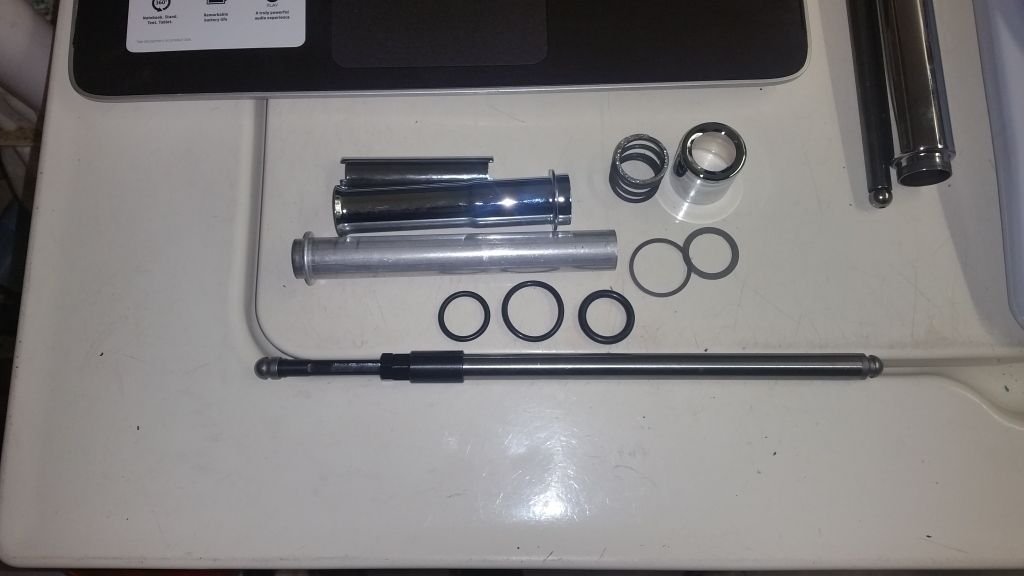

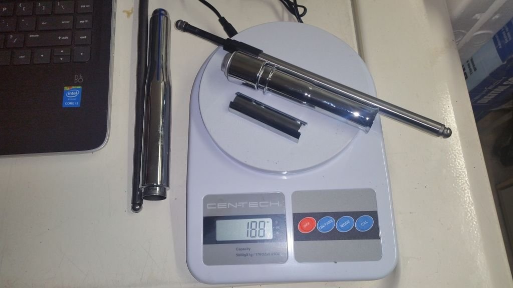

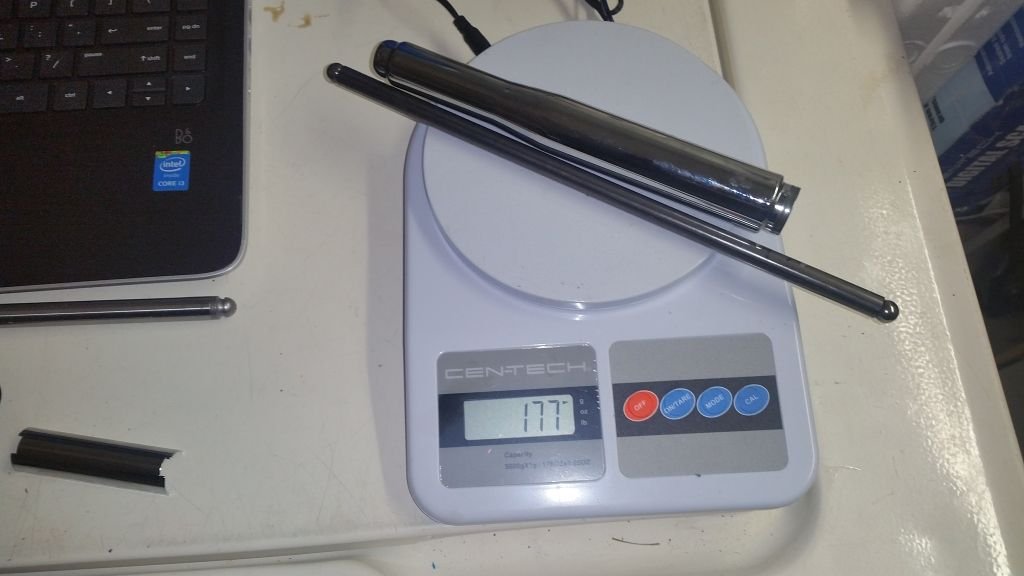

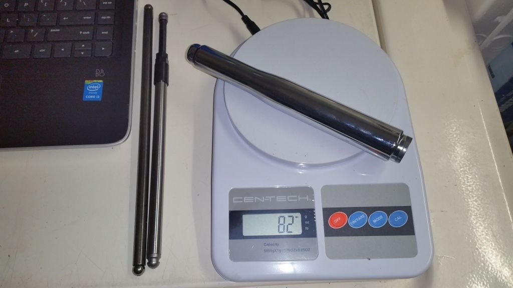

As far as added weight.... not sure it's really that big of a deal:
https://www.hdforums.com/forum/showp...&postcount=386
stockness
s&sness
stories of adjustables being heavy and weigh as much as 3 stock rods....

Pretty cool how cvaria has weighted them Only thing important to me would be the rod itself. I would have never guessed the adjustable is only 3 grams heavier. That is only .10 of an ounce. So that is not big deal. That larger tube must be a thinner wall.
