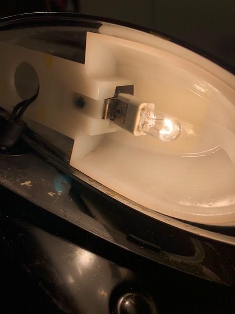

Default 52441-95 bulb replacement
I just took my fender light apart to replace a non-working bulb. The factory OEM bulb is a GE 168.
