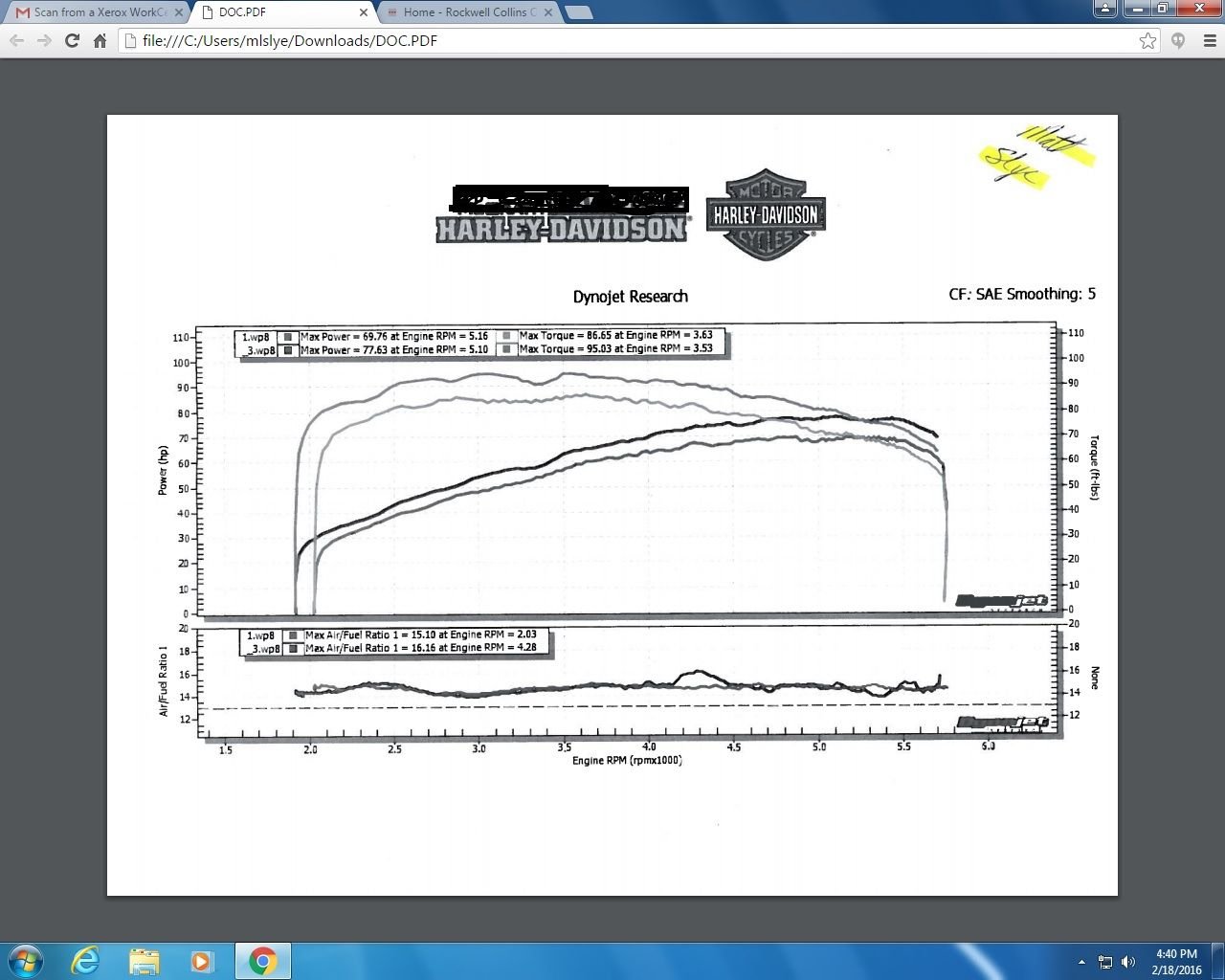

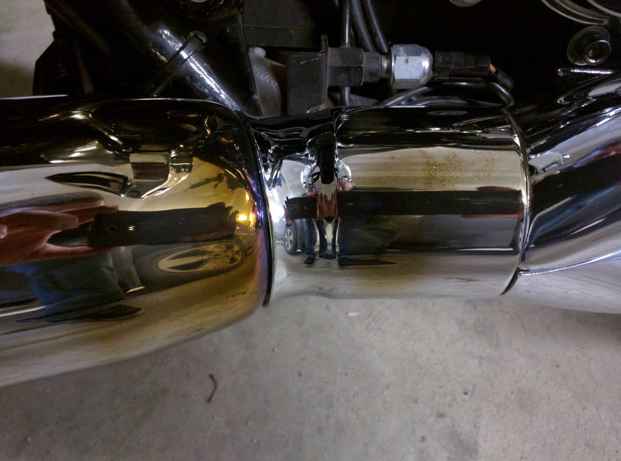

I just had my bike dyno tunes with my power vision. I'll upload a tune file tonight when off work. They overheated my pipe and blued and goldened the heat shield at the collector and muffler body. Looking at this chart I am way too lean. Any input here? Even turned gold at the muffler turn out at the tailpipe.

Yup, samething happened to me. I called Drago (who I bought the 2:1 pipe from) to see if that was normal or a defect in the chroming. His reply was with 2:1 pipes the tuner need to put a fan directly facing the collector cause the heat collects there. He was kind enough to sell me a new muffler at a discounted price. When I had my other bike tuned I relayed what Drago told me. He put a fan on the collector and it was fine. Lesson learned.

Jeez, No wonder. Give that puppy some fuel, That is a H-D Dealer EPA Lean as hell tune.

slydog- now what did they claim to "tune" exactly? I think you got taken to the cleaners, unless you specifically told them you want a maximum economy tune. Look at your AFR at bottom of chart printout. As Smokey said- "lean as hell". No wonder your pipes blued. is that 16.16 AFR the "after tuned" run?? the HP/TQ lines are fairly jaggy as well.
Lots of shops with a dyno but unfortunately very few are actually good dyno tuners.
