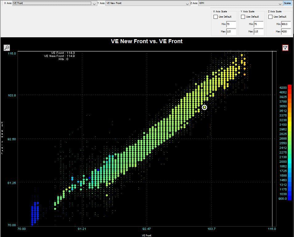

Hard to tell without the log. I can tell you what I do. If you look at the white circle, in the image below, the VE Front is 102.5 and the VE New Front 100.5. Going straight up from there the VE Front is 102.5 and the VE New Front is 107.
I try and get this as close as possible in the RPM range that I ride in most of the time (2200 - 4200).

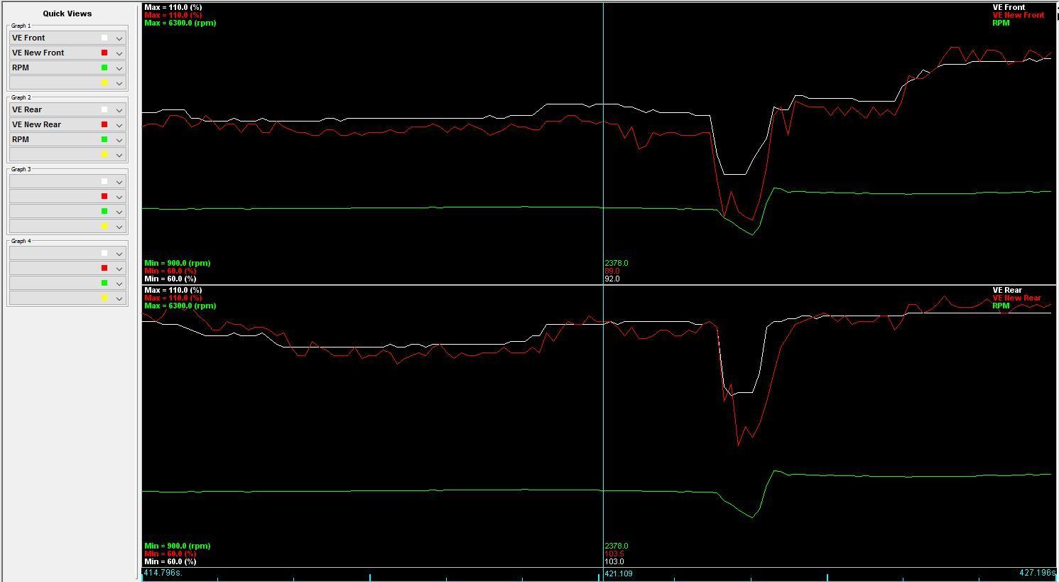

You can also look at it in Log Viewer mode and see if the large deltas are on shift changes.
