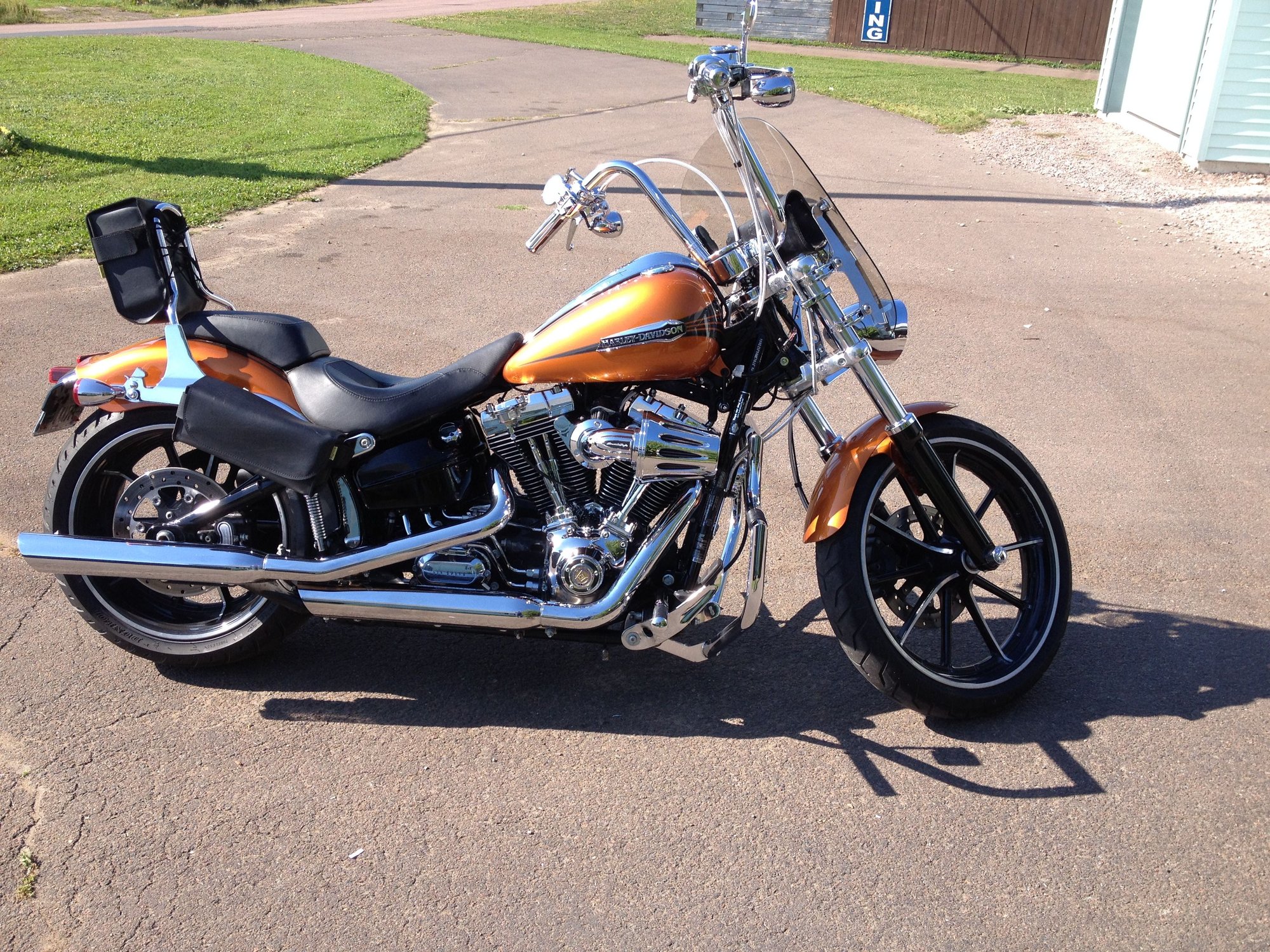

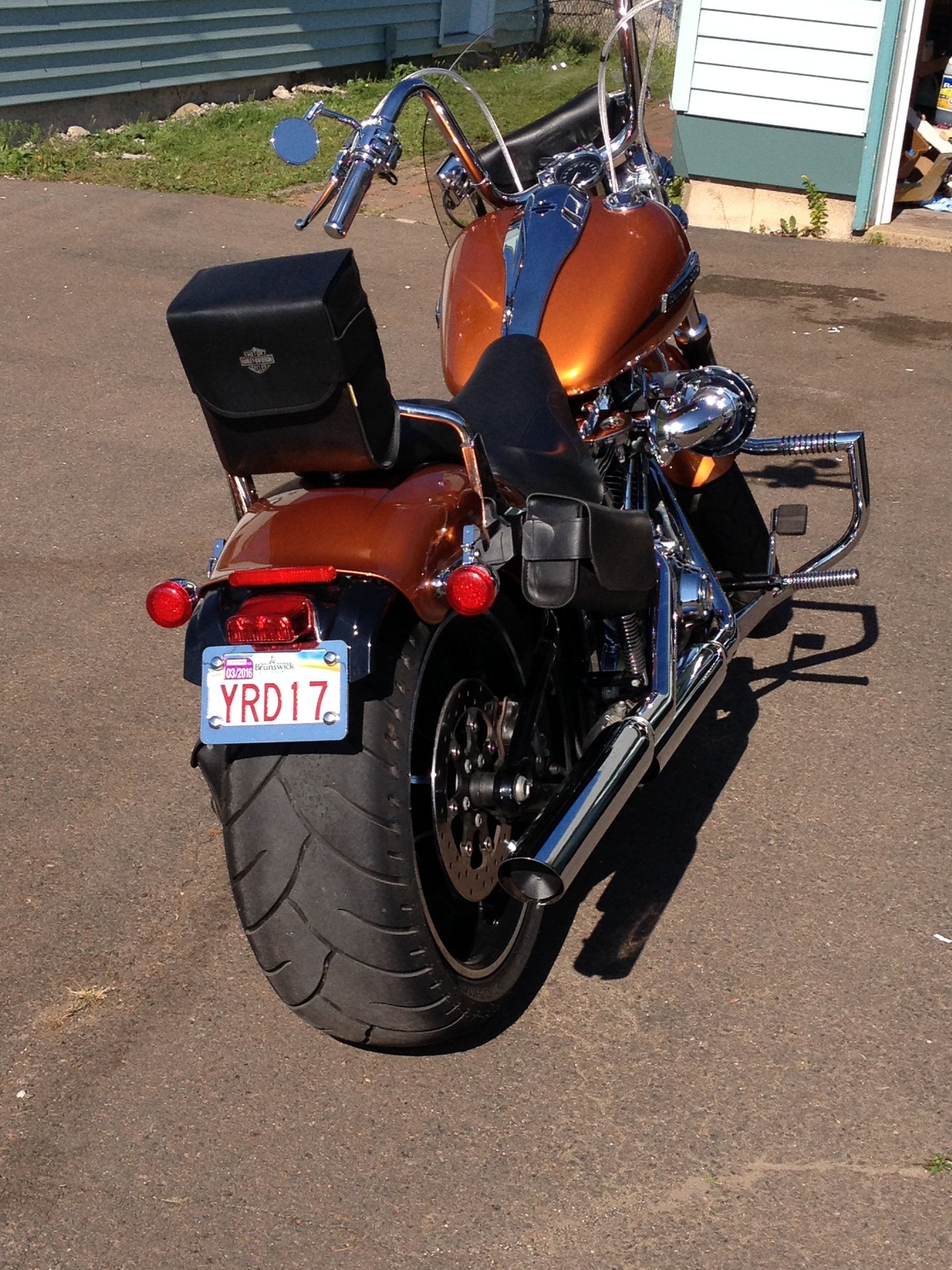

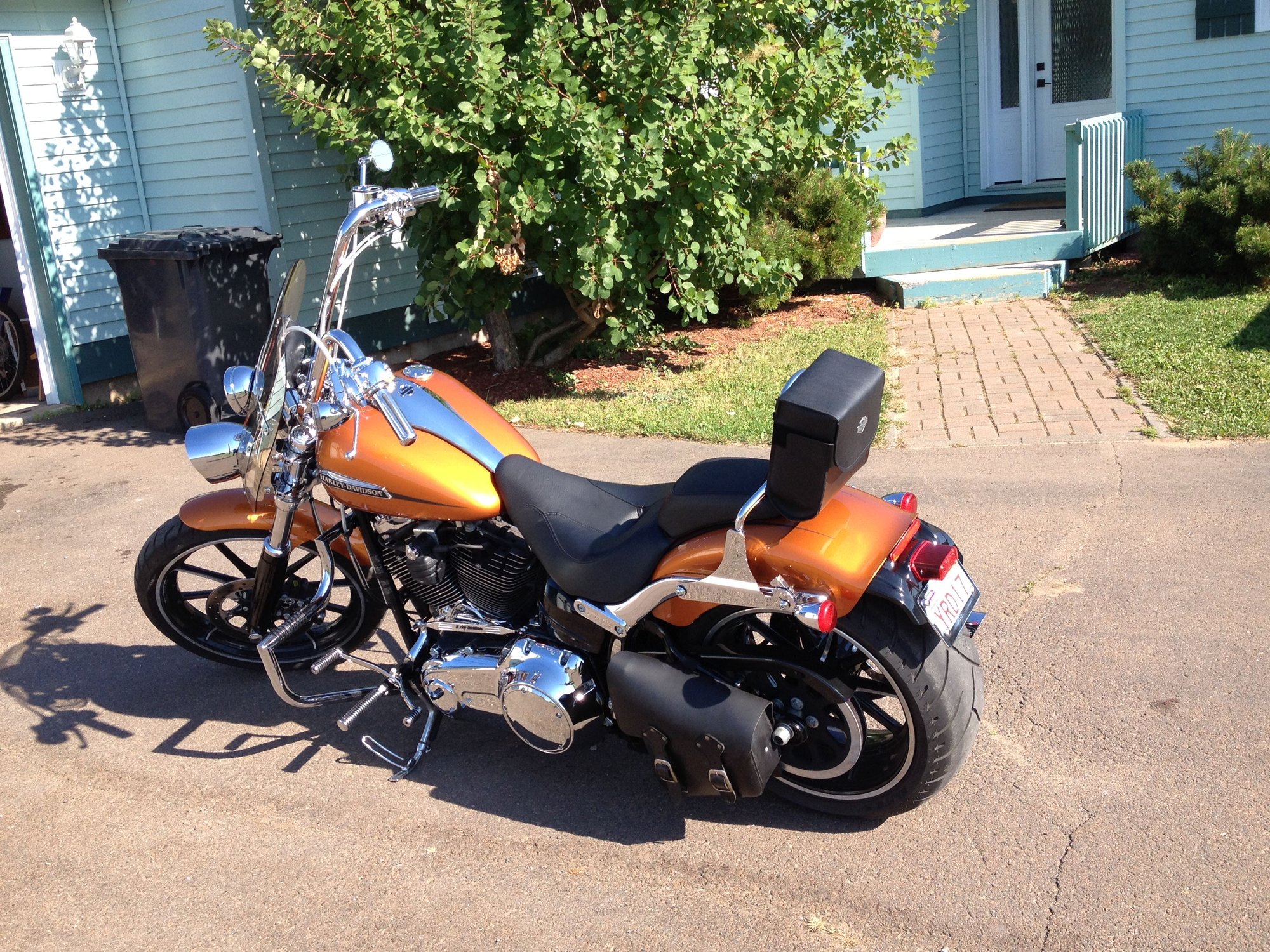

Originally Posted by JeepXK
Thank you
Can we get more pics of this bike? I'm intrigued as to what's been done on the higher front end.
Thanks
higher front end?

higher front end?
The bike with the two headlamps. I may have come into the thread late.
yeh- nicely done eh? i just wasn't sure what you meant about the front end being higher- looks to be stock height.
The only thing higher at the front is the tank. I did a DK 3" lift adding 14" apes using CVO risers mounted on 10 degree angled bushings so the speedo would clear the tank.
Nicely done- thanks for adding the pics and info, will certainly be of interest to others.
