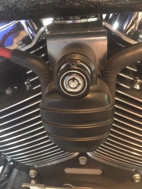

Originally Posted by NSR
That temp gauge/dip stick mod is really cool. Nice job.
How are the temp gauge and the cap joined/sealed together?
Set it with Automotive Goop and then poured in some Hi-Temp Silicone to seal it. Got the other thumb levers done. Shortened up the peg and did a silver inlay. Seems to look a little better than the first try.

Originally Posted by showin4fun
Just finished one up yesterday. Made a couple extra at the same time, I did mine with a small peg on top so it could be turned easily and then powder coated it satin black. Also did the flat on the bottom to match the HD switch so there would not be any gap.
Damn brother that looks clean!!! Very impressive, and better looking than the original IMO. Are you in the market to sell them...I see you mentioned that you made a couple extra. I'm a man in need...

Wow Jeff, excellent job on the ignition thumb lever. You should market those. Thats actually cooler than stock look.
