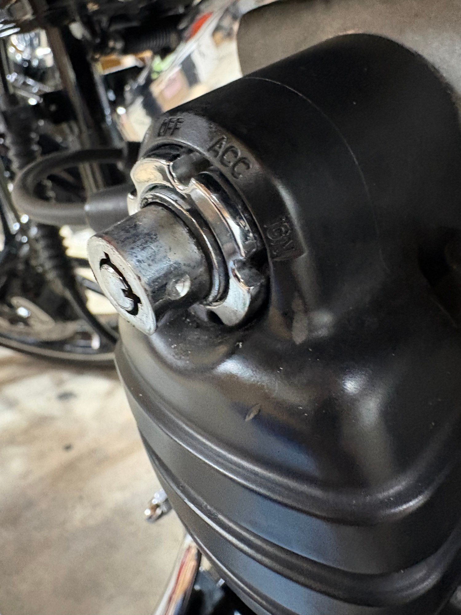

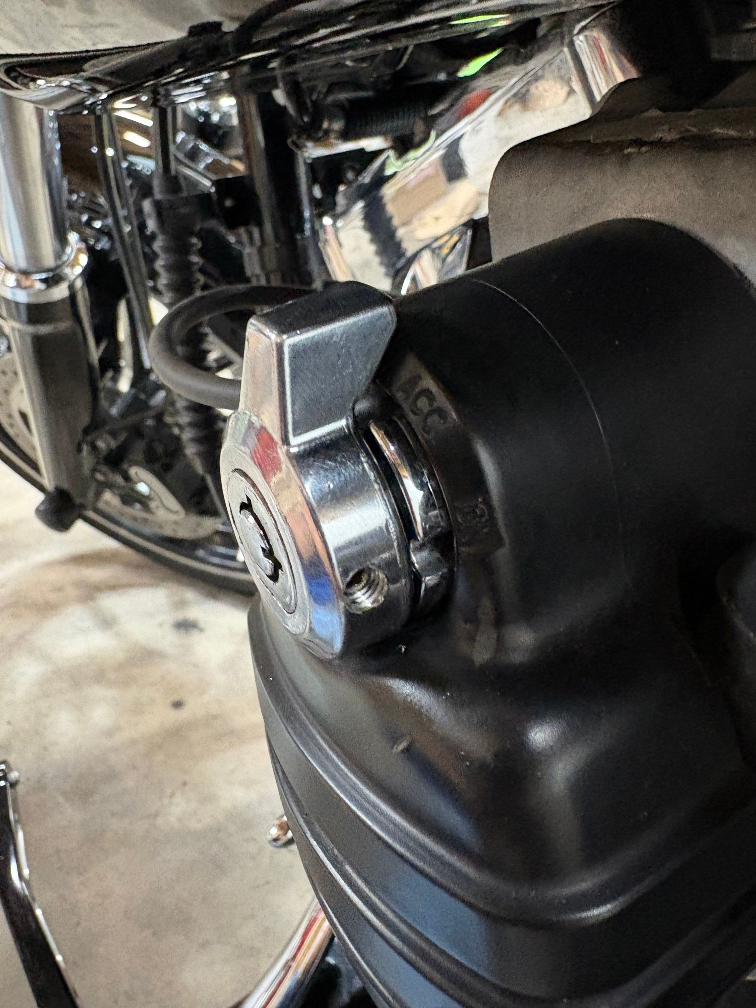

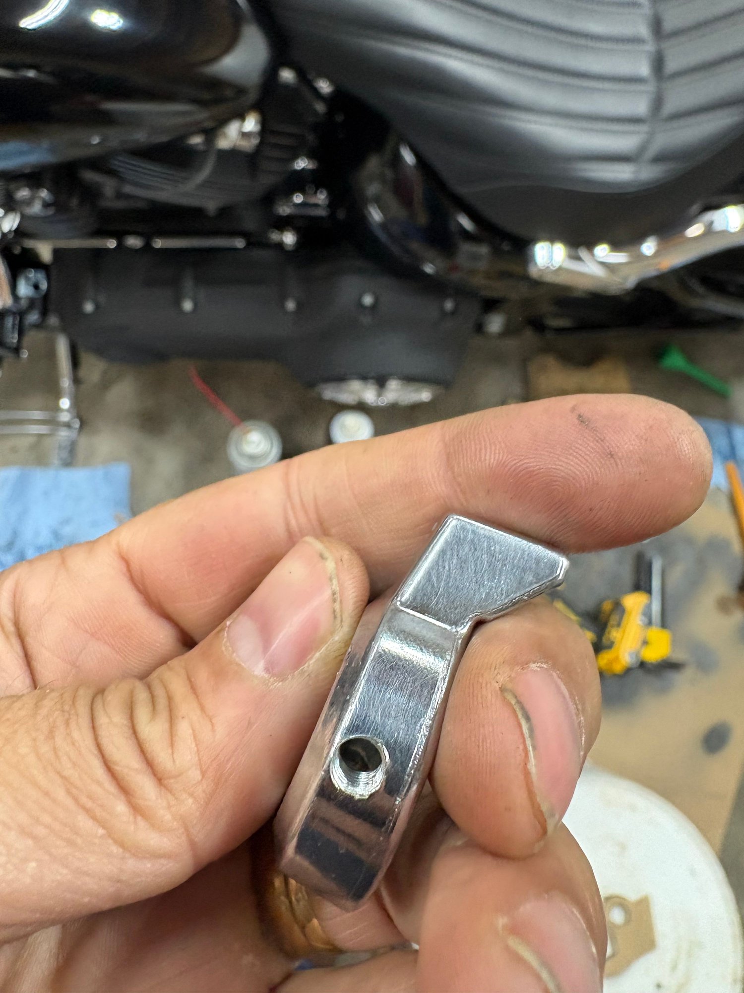

Old Jun 2, 2026 | 12:29 PM
  #39
marc_hanna's Avatar
marc_hanna
6th Gear
Joined: Jun 2026
Posts: 13
Likes: 6
From: Nova Scotia
I hope no one minds me reviving this old thread. Today I came up with my own solution for this.
I was having the same stiff/unusable lock problem. Any amount of pressure that was enough to keep the **** intact was making the lock unusable it worked with no pressure, but was still a little stiff. But it worked.
What I did was a drilled a 5/16" hole perpendicular to the existing threaded hole as well as a little dimple on the outside of the barrel in that location. Then I tapped the hole with an M5 x 0.8 and relocation the set screw there. To my surprise, after tightening down the set screw, the lock freed up. So the added benefit was truing up the barrel roundness.
To get the dimple until the barrel, so the screw has a place to locate, I installed the **** back on as normal after I had drilled the new hole, but before I tapped it. I then use the hole a drill guide/jig to position the dimple perfectly. The importance of doing the dimple first is to ensure you don't destroy your newly tapped threads.
Of course, to finish it off, blue Loctite on the threads.
I hope this helps someone else with the same problem.
