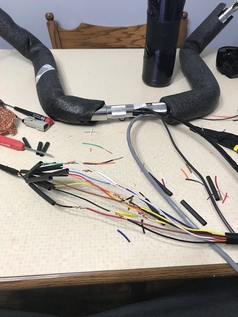

For the price of the Namz kit, you can buy the crimper, run a new length of 8 strand wire, solder it in up top, and make new connectors. Then everything is brand new and verified correct. I just don't trust jumpers inside those connectors as fragile as the MX series of molex connectors/pins are. Let me know if you need help identifying all your pins and connectors, literally did this two weeks ago.

Old May 10, 2018 | 10:49 AM
