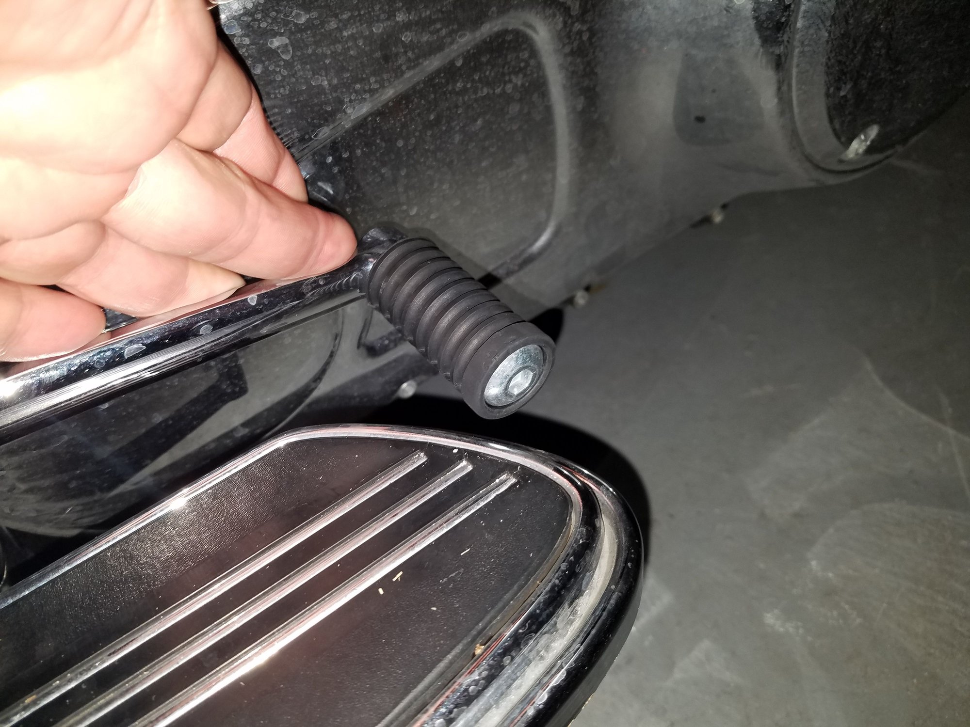

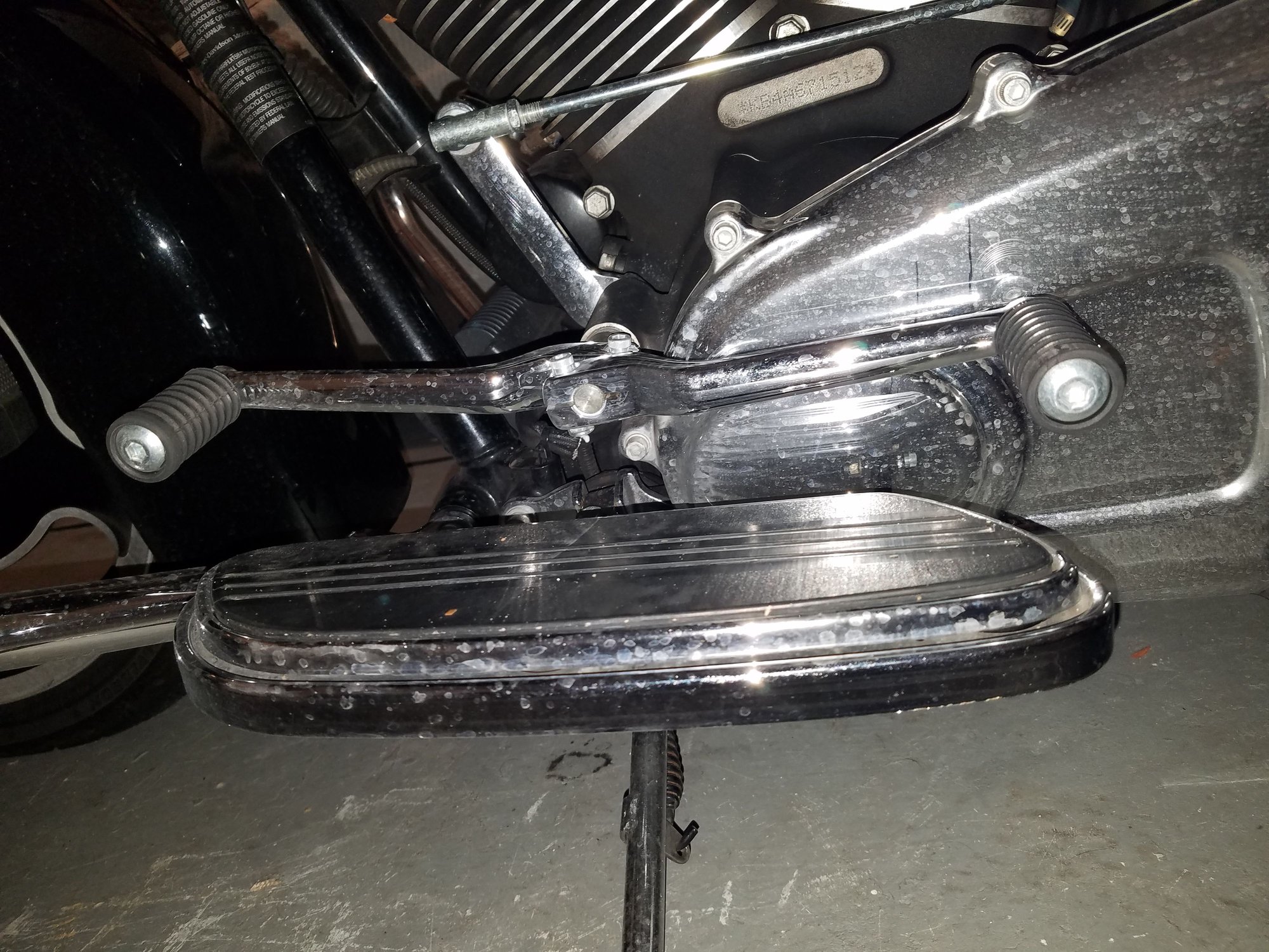

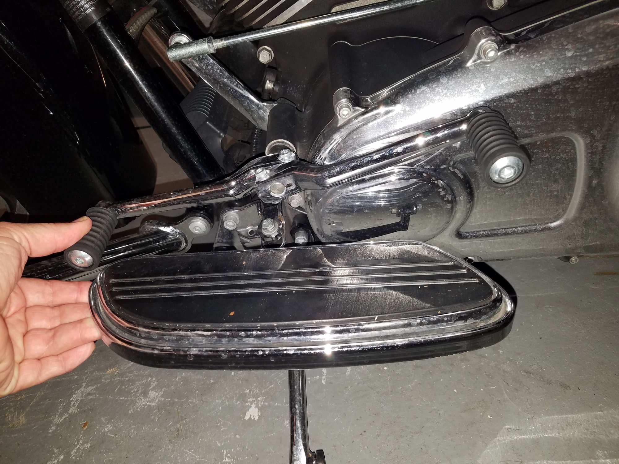

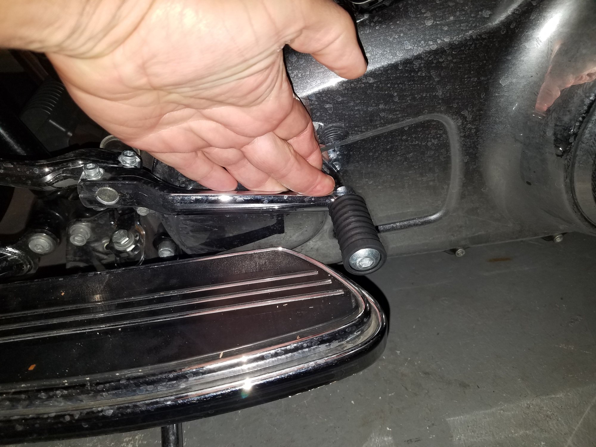

A different spin on extending stock shift pegs......
I moved my foot boards out an inch so wanted to extend my shift pegs an inch. I originally was going to use another stock peg rubber and cut it in half and get a longer bolt like many have done. I happen to look at the leftover spacers I had on hand from the 53804-06 detachable docking kit and got another idea. I used one spacer ( 53747-97) on each end of the stock peg, two 1” sleeve spacers from a hardware store and a 5/16-24 x 3 1/2 bolt. The sleeve spacers go inside the rubber only as the holes in the leftover docking kit spacers are exactly 5/16 ID. I happened to have 4 spacers from the two different docking kits on hand so I did both pegs. This makes the 2” stock peg now 3” long and adds a touch of chrome without changing the pegs altogether. I think it looks like it was made that way. Now all I have to do is purchase one of the extended heel shifter arms to make more room on the board.

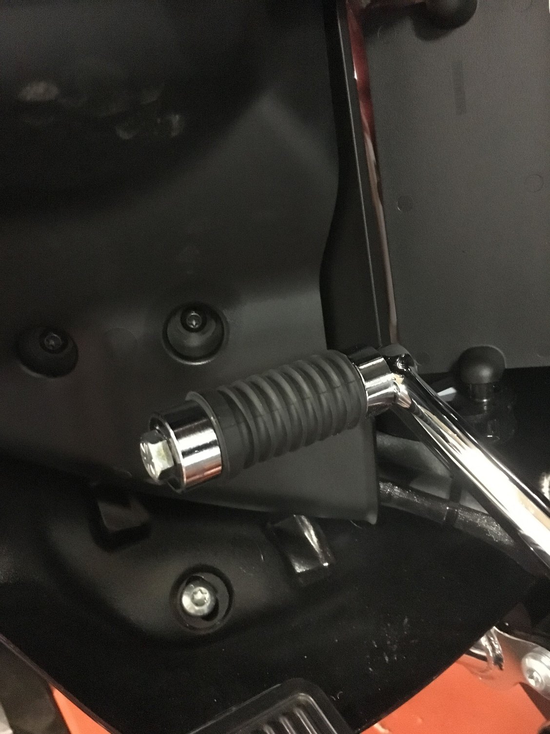

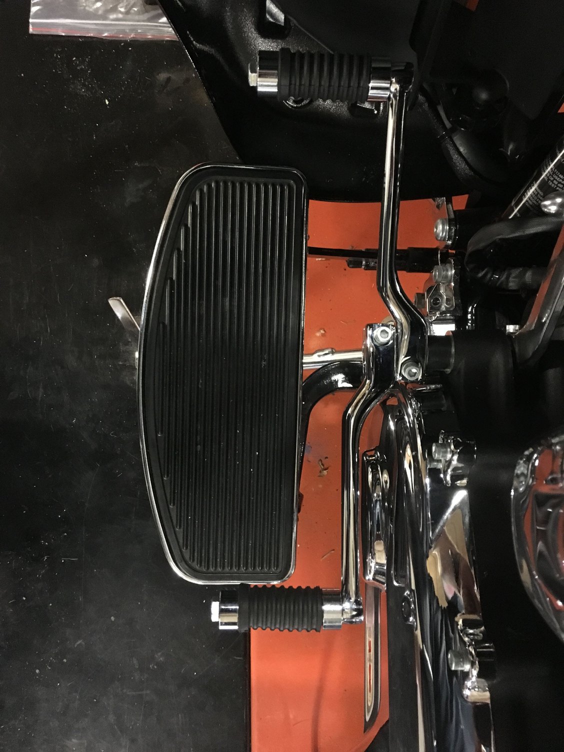

hey Dawg, HomeDepot has very long bolts only in the "Grade 8" section, and they are black anodized, with a socket, will look much better in your pegs.
my SG came with "floorboard extenders" on it, and i recently adjusted my pegs to be flat
FWiW, I like my pegs to be almost flat with the floor board, so you can "sub-liminally" shift without completely lifting your foot off the floorboard. i noticed today I could keep either my toe or heel on the board while I hit the pegs
you have to adjust the jam nuts & the reach rods to properly locate the spline shaft so the pegs lay evenly flat.
but its worth,with the floorboard extenders, you can really get the shift pegs low
