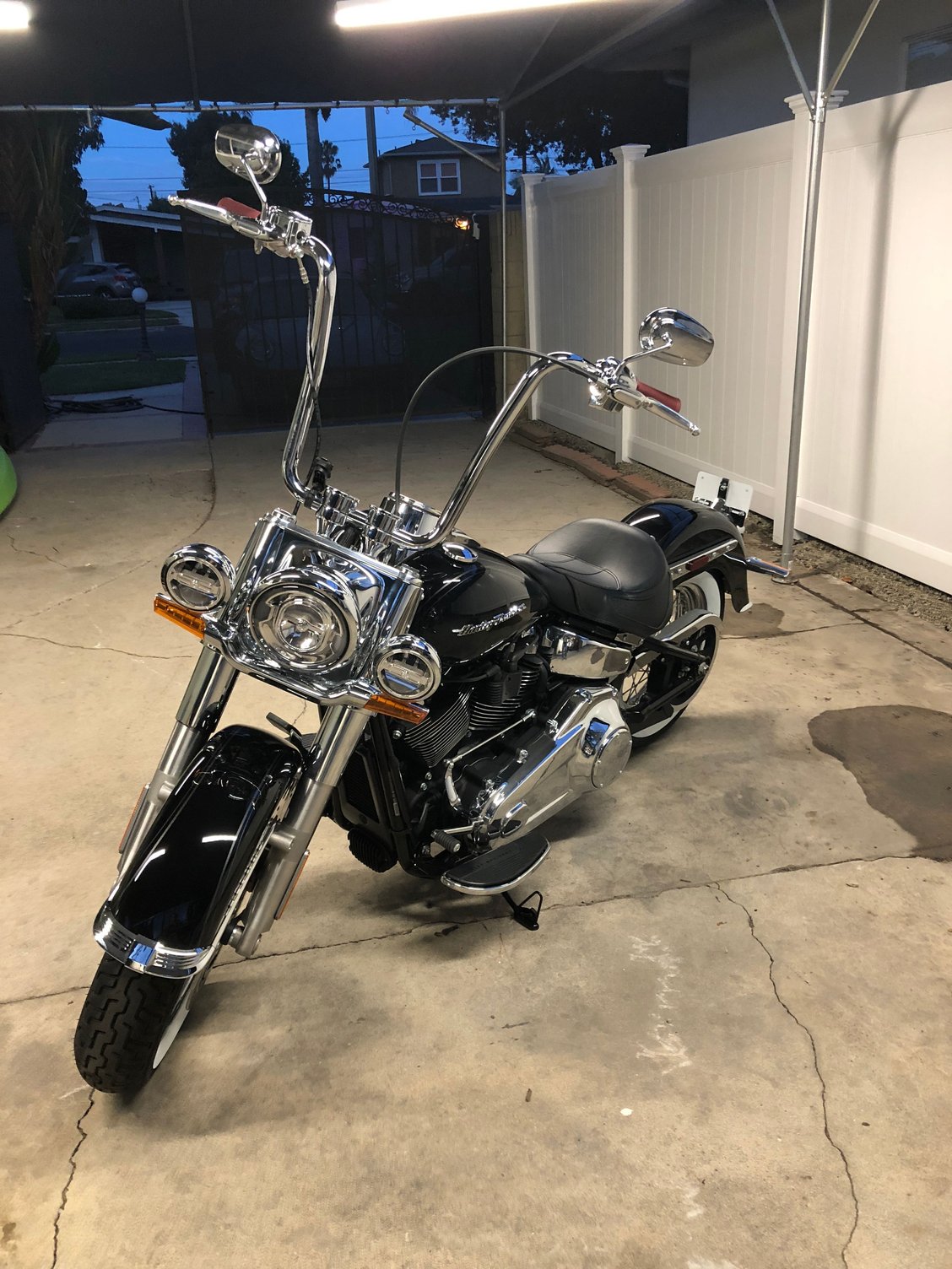

Added new 16" carline gangster ape, very happy with the results
