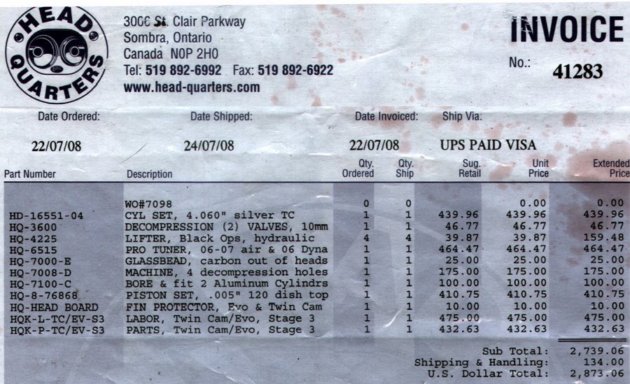

Originally Posted by djl
I hear ya on the 117" although I don't see another $1000,
maybe $700 for cylinders and case bore;
right.
back in 2008 when I built my 121 inch monster
bore case - 195
cylinders - 440
