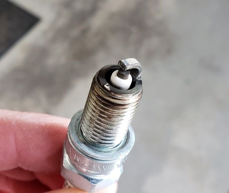

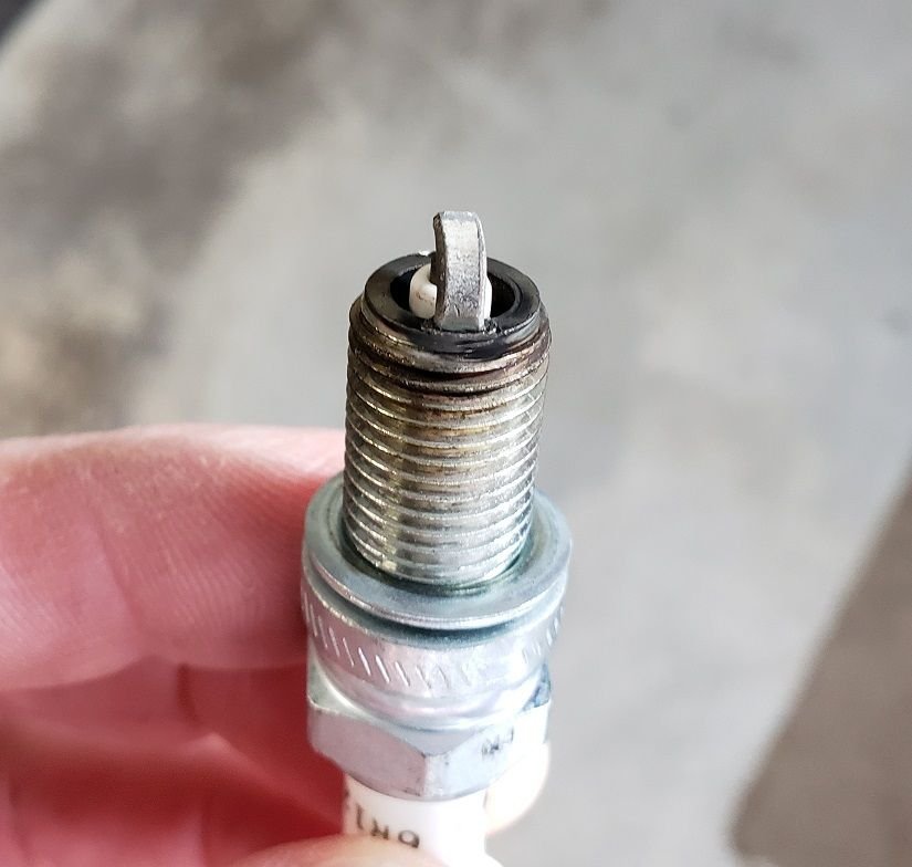

Originally Posted by guitarfish
Here's what running V&H Big Shots without a tuner for 10K miles looks like. Pretty lean.
If you're going to upgrade your Harley, any Harley, you need to do a Stage I. Full exhaust, (slip-ons at a minimum), open air box and a tune. You can't do any major changes to air flow without a tune. Your bike will never run right and you won't be able to get maximum power...
I understand. My previous (first) bike, 07 Sportster, had the intake & exhaust done without a tuner, and it was having major problems. I got a tuner, it was great. The "conventional wisdom" over in the Sporty section has been that you can do pipes only without a tuner, so I thought my Low Rider would be OK with just the pipes. Apparently not.
The cost difference between the FP3 and the Power Vision is only $70 at Fuel Moto, so the PV seems like a no brainer. Plus it can be used on another bike for around $190 if I read that right. So there's going to be a PV in my future.
The interesting thing is that nobody is talking about the Harley tuner. Since they quit selling the Pro, why bother? You need a tuner, hopefully one that is not permanently attached to the bike, that gives you various tuning options. If that tuner can be moved to another bike, even for an additional cost, is a plus.

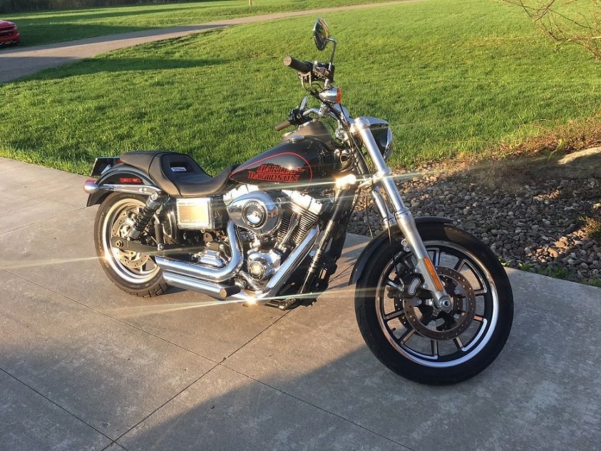

Two straight days commuting to work. Approaching 22,000 miles.
