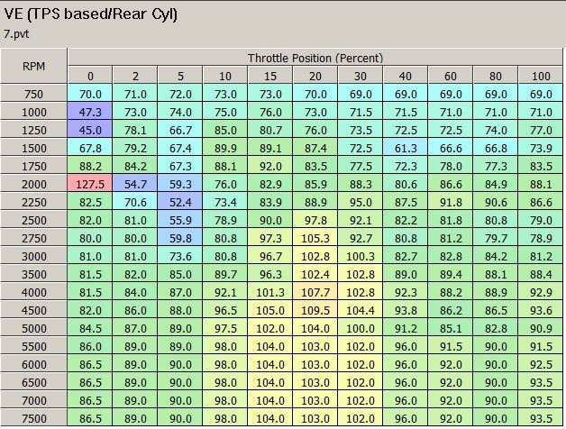

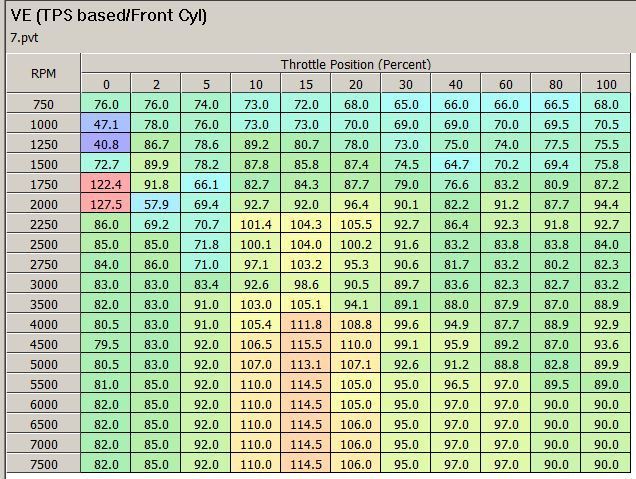

I think I have a similar situation going on although it with autotune not target tune. After the first few autotune runs, the 2000 RPM area on both the front and rear VE's maxes out at 127.5 and I choose to cap. I did as fuelmoto suggested in the above post and in the autotune settings selected to not tune under 30 kpa and started over autotuning from my base map. I am still maxing out the VE's in the 200 RPM range and I'm not sure what the next step is. If anybody has any ideas please let me know. Also, if somebody will tell me how to post screenshots from winpv, I can post up my autotune results.

Attached are the front and rear VE tables after doing 7 autotune runs.
The bike I am tuning is a 2005 softail deuce with a Kuryaken air cleaner, V&H Big Radius 2 into 2 pipes with big city thunder baffles, and Andrews 21 cams. I am using the Powervision with the wideband O2 sensors.
Fuelmoto didn't have a base map for this set up so I emailed Dynojet and they provided one. I don't know if this matters but the map Dynojet provided was from a Dyna instead of a Softail. I know the Dyna motors aren't balanced but I'm not sure of that makes a difference for tuning or not.
Is a datalog made when I run an autotune or is that something seperate that I need to run? I should be able to get out on the bike tomorrow so I could run a datalog and upload it here.
Also let me know if you need any more info.
Thanks for the help.
Front VE
Rear VE

I need a data log that has
MAP
RPM
PW front and rear
O2 sensor volts front and rear
TPS
AFF front and rear
CLI front and rear
Spark retard front and rear
VSS
It is set up from the PV Logging fields screen
Then log for about 45 min ride from the backroads, not just highway
Andy

Looks like a bunch of exhaust reversion.Like to see a data log also.

You're really chasing a non-issue anyway, you're rarely, if ever, at actual 0% throttle, especially at 1750 or 2000 rpm, and even if you were it most likely won't cause any sort of rideability issue. I haven't played with throttle percentages lately, I'm not sure you can even get to an actual 0% throttle reading??
I'd agree that if it is a true reading it's most likely caused by reversion in those short pipes.
