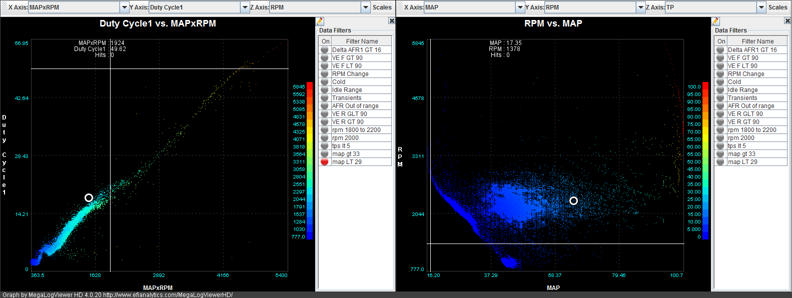

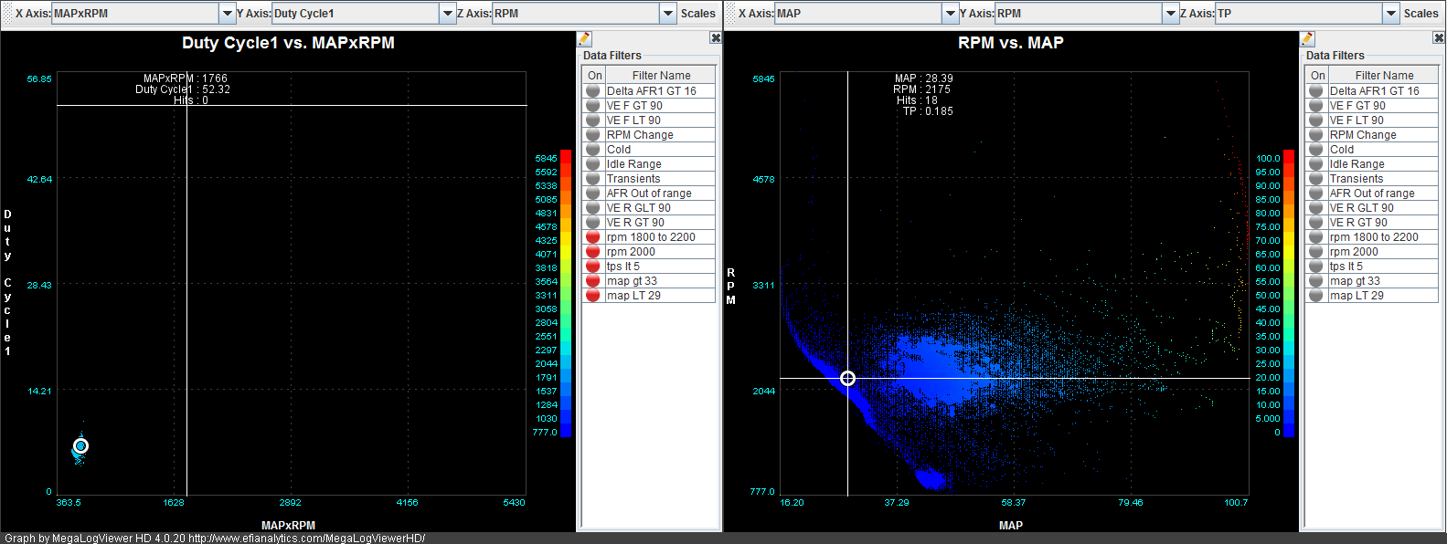

Originally Posted by Yookdew
I just ran another datalog with the correct sensors which is attached.
I am not able to get the O2 voltage or the CLI to show any data when I datalog. I think this is because my bike is a 2005 which is an open loop system that does not use the narrowband O2 sensors. I am using the Auutotune Pro with the wideband sensors to tune it. It will only allow me to log AFR or Lambda from the wideband O2 sensors. I went ahead and logged AFR but I don't know if that will help or not.
Hopefully this datalog has enough info that it can give you an idea of what the issue is and how to solve it.
Once again, thanks for the help.
Well, not enough info for me in the second log, but I was able to narrow things down in the first.
That little hiccup spot occurs in a very tight range of RPM, MAP and TP. RPM is between 1800 and 2200, MAP is between 26-32 KPa, and throttle position is less than 0.5% - so closed. You knew the RPM range and TP, but the MAP gives a little more info.
Now at that RPM with a closed throttle, I'd expect to see low MAP, but you've got a cruising MAP with throttle maybe 5%-10%. I'm thinking intake reversion (duh-duh -duhhhh - Just like Jamie said, whatcha know...).
Again, just like Jamie said, you can set the MAP min to about 30 KPa and it PV should ignore that area.
Here's the MAPx RPM vs Duty cycle front without filter...
And here's the same graph with only those pints less than 30 KPa...
And here it is with only those pints greater than 35 KPa.
Hate to say it but it looks like your cut off is about 35 KPa... anything less than 35 left that "hump".
The VE's I originally posted were after running autotunes with the minimum MAP set to 30. What other options do I have to deal with this problem?
Thanks
Yep, took another look and it looks like you wont get rid of that issue until about 35 KPA (see edited graphs above).
The only other thing I can think of is manually inputting the VEs for those two areas using adjacent cells, or interpolating between cells. It is in the 0% TP so little to gain or loose...
Here's the graph with only TP < 1% removed...
Looks almost like a straight line...
