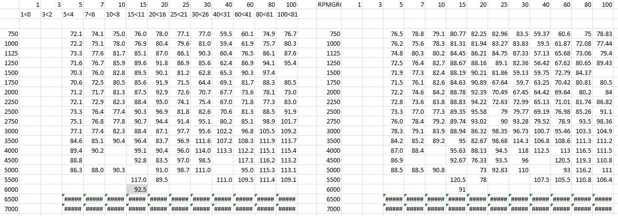

I have a question regarding PowerVision Basic tuning from a Log file. So I ran all season and logged a bunch while riding. Over the winter I have created a spreadsheet that is populated with all that data, populating the VE tables from the log files. What can I expect if i drop these into a map and run it? The VE's should be bang on, but they are logged from open and closed loop, so i don't know how reliable they will be? So I guess my other question is? Can i get reliable VE's from open loop logging? thanks.

The logs are showing the data calculating the VEs open or closed loop. So answer to your question is yes.
question is how useful is the data
You using the bike sensors or PV wideband? Is it a target tune or autotune box?
Are you working with original AFR table or have you adjusted it before logging the VEs?
