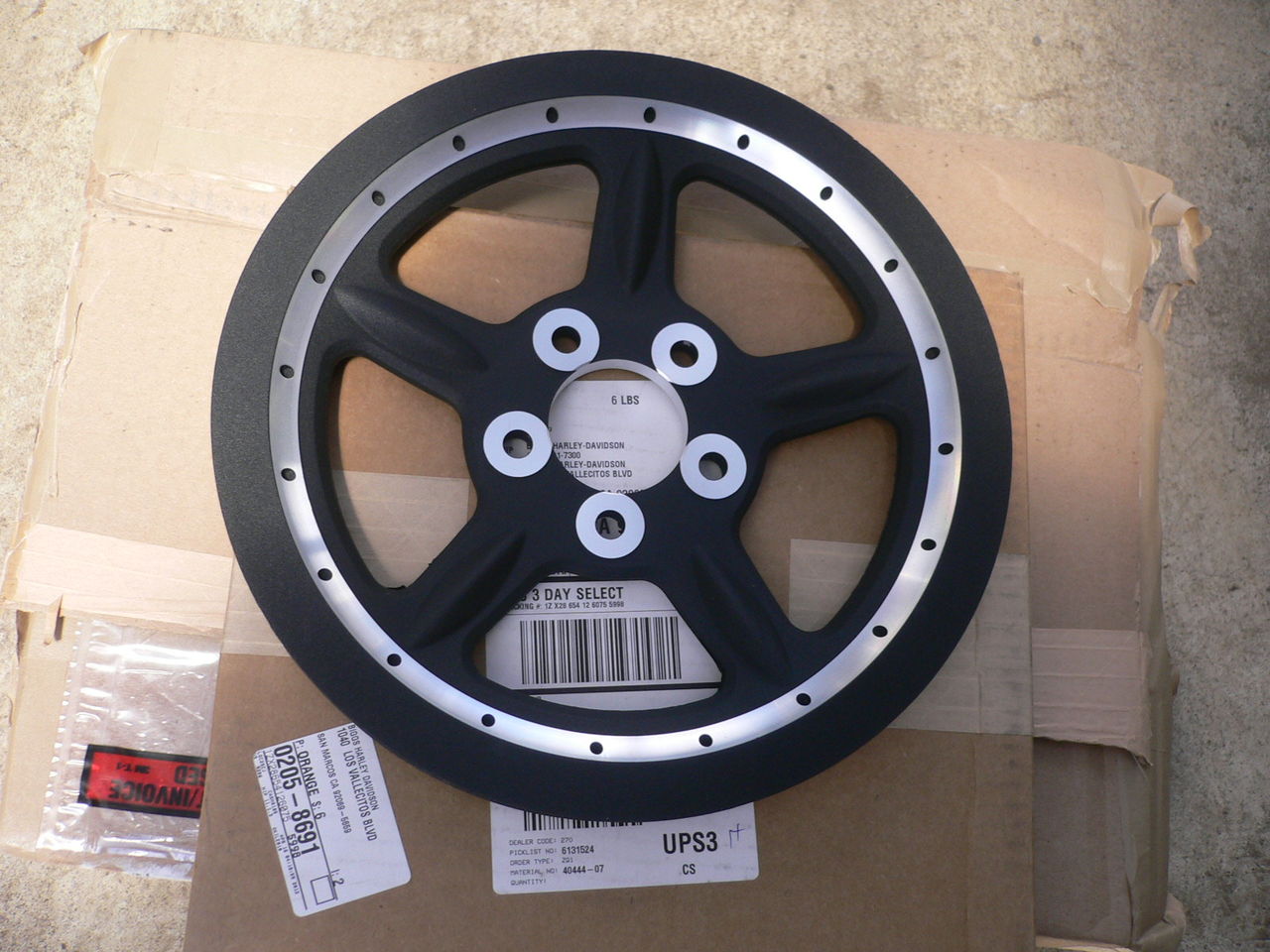

Sportster 1200 68T rear pulley and bolts that can be used for the swap on FXSB Breakout:
2011 XL1200 pulley PN 40444-07 - or - can use PN 40350-07 pulley for 2007 and up XL 1200's as it is still used on the 2013 XL1200 72.
The 40350-07 has a machine finish outer rim where the 40444-07 has a black outer rim. both have the machine finish detail on the inner part of outer rim with the black dots. otherwise it's the same sprocket.
I will probably order the 40444-07 pulley and also the PN 3899 sportster pulley bolts, 7/16-14 x 1-3/4" - Same bolts as the Breakout but shorter length. The sportster pulley is thinner on the bolt area so the Breakout's 2-5/8" length bolts will be too long.
Pulley bolt tightening:
Never re-use the pulley bolts, always use new ones.
Tighten using the following sequence:
a. Tighten to an initial torque of 60 ft-lbs (81.4 Nm).
b. Back off 1/2 turn (180 degrees).
c. Tighten to a final torque of 77-83 ft-lbs (104.5-112.6 Nm).
Surdyke seems to have the best price on the pulley ($157) and free ship on orders over $149 until May 05. The bolts are $1.09 each and washers (PN 6516HW WASHER 7/16 X 1-1/8 X 1/8) are another $1. Five of each on bolts / washers are needed. If you buy bolts at the hardware store instead, make sure they are Grade 8.
As a side note, touring bikes would use the 40518-08 rear pulley, still current to 2015 on XL Superlow, Custom, etc, as it has the built in bearing and cush-drive compatibility.
40350-07 pulley:
40444-07 pulley:

Jgos- I don't expect a big change from the rear pulley swap, as JimG mentioned earlier it is only a 3% change in gearing- should help a bit with take-off from stop and roll-on from cruise, every little bit counts. eventually I still want to drop in a smaller front pulley. I think the XL pulley actually looks nicer than the BO pulley, I was kinda surprised..

Thanks for taking the time to research and post this LA Dog. It is valuable info for others! Be sure to let us know how much of a difference the rehearing seems to make once you have the pulley swapped!
Jim G

Jim- I can pretty much guarantee it's only going to be a small difference, but I will definitely post my impressions of the install process and the ride test.
