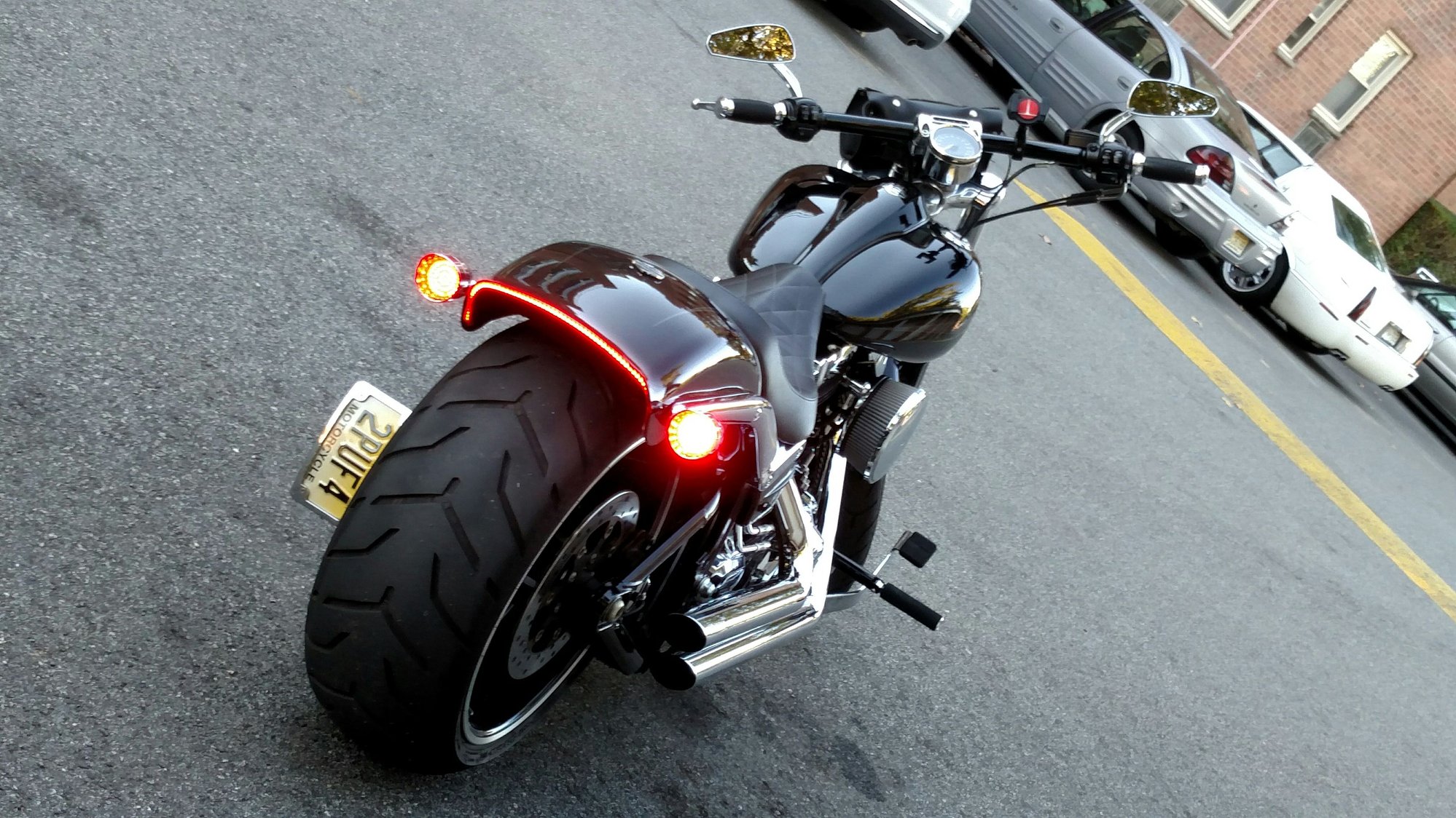

Jim, fwiw at one point I had the CD LED's in my 2014 bike - front and rear. I did not require a can bus adapter. The bike learned the new lights. Everything worked fine. One hundred percent plug-n-play.
Then I yanked the front signals off the bars in order to install Primo Rivera's LED headlamp w/ built in signals ... and that's where my problems started, lol... the bike simply did not want to learn the PR LED's for some reason. No biggie really - the indicators in the speedo just flashed fast. The bike flashed the LED's at the correct interval/rate/speed.
THEN I switched out the headlamp again - the Primo was not bright enough for me. I got something off eBay in the bike now. I'ts ok - better than the Primo was anyhow. It does not have signals built in. I kinda like having front signals for some reason, so I did LADog's mini LED install. They're bright and they work great ... but the bike still won't learn them so the indicators in the speedo are still flashing fast.... I don't really care though.
So, short story is that the CD LED's will be fine. I still have 'em in the tail light housings. Couldn't be happier.

NSR- nice pics, looks like the next cover of "Hot Bike Magazine" to me
Yeh my indicators flash fast but signals themselves flash normal. seems very common on the bikes with BCM module vs the previous generation and TSSM.
What did you go with for headlight? I'm using an 80w H4 LED bulb off ebay that I fabricated into the bucket. bright as hell. I flipped the glass and reflector housing upside down and it throws a good cut line. I know, weird right? anyway a lot of the time my high beam indicator comes on for no reason. probably has to do with the LED not providing the same level of resistance feedback to the BCM.
BTW that Primo LED headlight ((SUCKS)). tried it. no brighter than an OE halogen. some of the china daymaker clones for looking pretty decent though at $80 range. a few of them are full 40w cree leds. might pick one up.
