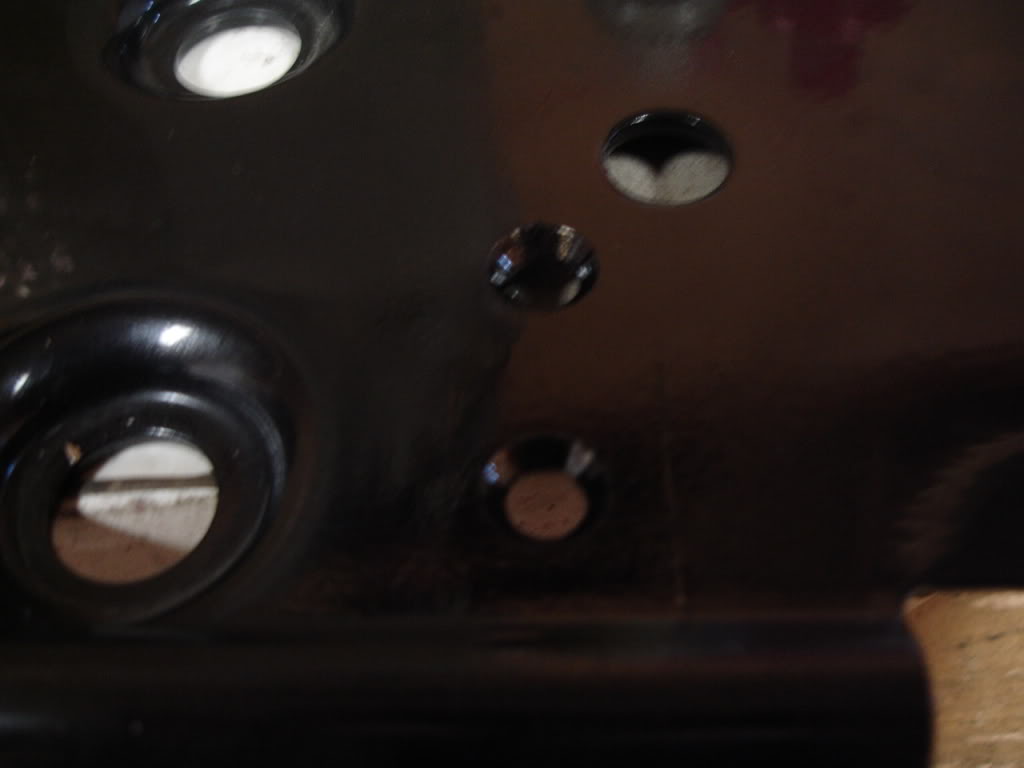

ok ive melted my boot on the exhaust for the last time..
my boot heel has mellted on the exhaust more than once ..carl miles heel guard for harley footboards are $68.00 on ebay for $3.00 worth of material..their instructions show spacers to clear side lip of floor board i notched mine to allow for better fit and it will be much stringer this way will also slot 2 of the holes for adjustment..
so i decided to make my own..simple but effective.the pic above shows the turn out style they also make a turn down and a smaller straight guard..i decided on the smaller straight style.
materials needed:
6" - 3/4"x1/8" flat bar
6" - 5/16" round bar
2 - bolts of choice [ i went with 1/4" stainless with nylocs ]
so heres a couple pics first i cut the flatbar to length then bent it at 90*.then cut the round bar to length and chamfered the ends

time to drill some holes and countersink them for smoother finish and more clearance
